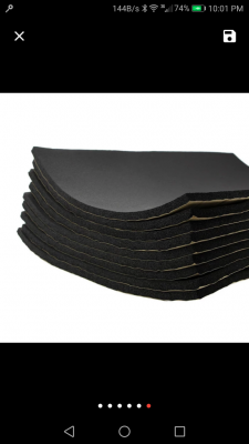

Buy some closed cell foam, self sticking and worked great. Rattle actually comes from the area just above the switch where you have that brushed looking detail on door. I put 2 pieces of closed cell foam on top of each other, puts pressure in that area and stops rattle. I already had butyl sound deadened door and closed cell foam finally worked. Closed cell foam is kind of like thicker self stick scuba type material. I bought about 8(about 8x14 inch) pieces off ali express for like $8 shipped for all. Here is what it looks like, got picture from ali express, amazon etc has it too, just a lot more expensive.
