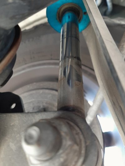

I noticed this today from my rear shock shafts so it seems it's time to service them.
Fronts are dry so that's a good thing but if i'll service the rears i guess this will be the time to service and revalve front and rear and be done with it.

And to think the rear of the truck doesn't see much abuse ha :)
Funny cause a post from @revitupmoto33 yesterday made me check today. Lol
King offer a bunch of different options so i'll check them out first as they're only 30 min away from home. I emailed them tonight to check on my options as i really want to learn to do this myself.

My pass side looks similar to your pic, still has pressure so just a slow leak, driver side has zero pressure left.
The seals and valves themselves are fairly cheap if you end up doing them yourself. The first time I did it was able to find some helpful videos on YouTube. Trickiest part is removing the floating piston out of the resi, either need to make or buy one specific tool.

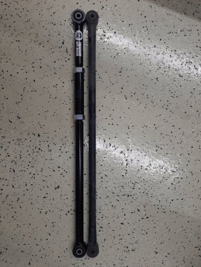

I'm going to replace my Bwoody rear track bar with the Freedom offroad performance trackbar
Freedom offfroad is DOM steel tube and feels a lot stronger than the Bwoody one.
Stocker vs Freedom Offroad
49571747432_d8810ca23f_k.jpg2020-02-22_04-02-28 by RAM RSM, on Flickr
I know you push these pretty hard off road, but how long have you had them on? Like a year and half? How many miles on them?
From my notes: 14 months and 23k miles.
I'm surprised it's the rear ones leaking and not the fronts considering the fronts are the ones i know have had the most abuse. it's a very minor leak so I'd think is just the wiper seals going kaput in the back but i'll know more later on. Haven't have the chance to take the shocks off the truck yet. my 1/2" Wulf front strut spacers showed up this morning so i'll try to the install the Ranchos backup this coming weekend and tackle the Kings on the side. The 1/2" spacers should put the Rancho QL's at 2.5" lift front.
Haven't decided yet what to do but i think i'll want to upgrade the front CO's to 600lbs springs and release some of the preload i've to have with the 500lbs ones.

Both of my rears were wiper seal fails, couldn't find any other issue when I had them apart.
About changing to 600lb springs, Im curious to see if the increase in rebound force would be more or less than the rebound from the 500lb ones being preloaded. Changing the rebound valving on mine solved the pogo effect I was experiencing.

Rebuild price from Kings is $120 per CO/shock
I'm so lazy to take the front ones out because they're not leaking . The rears shocks are just a breeze so i'm getting inclined to take the rears off tomorrow to start, i'll figure around $300, The guy from King i spoke with today said i'll probablky spend around that much trying to do it myself the 1st time since i don't have any of the needed tools, plus oil and seal kits etc etc. and he recommended of course to leave it to the pros.
Turn around time is 1 week.

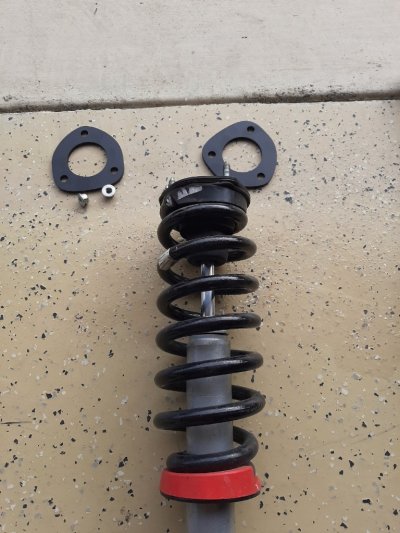

Got her all done today. Easy peasy just about half day of work taking my time to torque everything and take measurements etc,etc.
Rancho QL's are just awesome, install couldn't get any easier
This are the Wulf 1/2" top spacers from Amazon

Installation procedure:
It's super involved lol
Put the spacer on top and sip on a beer :)

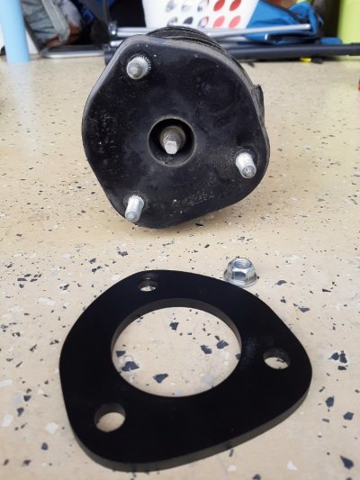

49602821902_214b7faa69_k.jpg2020-02-29_07-12-25 by RAM RSM, on Flickr
After taking the coilover out
49602559866_32bf7a835d_k.jpg2020-02-29_07-12-51 by RAM RSM, on Flickr

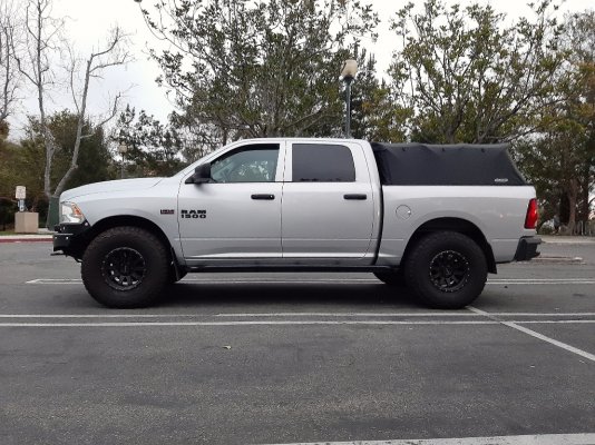

And running 37's on Rancho QL struts with a 1/2" top spacer. I wouldn't run any other spacer taller than that. Zero issues with the tires rubbing. (still a little cosmetic rub but the spot is rubbing about the same, 2.5" or 2.75" makes zero difference for rubbing in my case, My caster should be still more advanced than stock and i doubt caster changed just because she went down 1/4" inch, truck is tracking straight, steering is straigth so i won't bother with alignment until i get the Kings back after maintance and revalving)
Having a second set of shocks to run as backup is giving me zero downtime, so now i can take my time to decide who's going to do the job :) Accutune didn't reply so i'll have to contact them again on Monday.

Some of the measurements i took today for fun. I want to see what the difference will be once i get my CO's back with different springs.
Kings
With full weight on the CO's the springs measure 8 7/8, the spring free lenght is supposed to be 14" according to what i have stamped on the Springs so the weight of the truck is pretty much compressing them 5 1/8"
With the front fully drooped the spring measures 10 3/4 (this is with 11 turns on the driver side)
Tire to fender with full weight: 5 3/4"
Suspension fully dropped: 8 1/2"
Rancho QL with 1/2" spacer
Tire to fender with full weight: 5 1/2"
Suspension fully drooped: 9 1/4"
1/2" spacer is dropping the front tires 3/4" compared to my King setup, not bad considering the Kings are providing 2.75" lift vs 2.5" with Rancho QL + spacer.

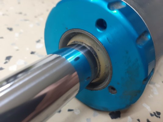

The rear shocks doesn't look as bad as i thought, there is a little buildup outside the seal

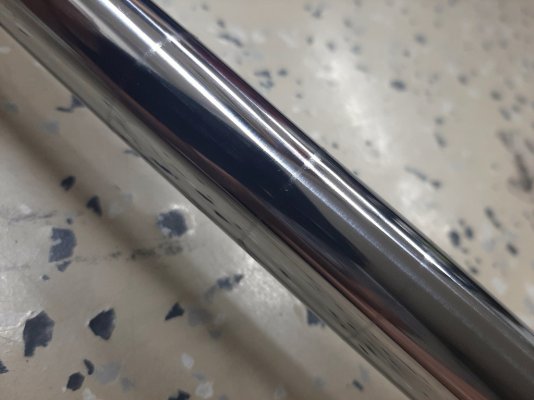

49605750912_f5a7d96d2d_k.jpg2020-03-01_10-24-55 by RAM RSM, on Flickr
i don't think i should see this marks when compressing the shock by hand after cleaning the shaft.

On mine their was evidence of shock oil spraying the coils and axle. How does the compression feel when you push down on the shocks and is there any freeplay, most noticeable fully extended in the first 1/2", will tell you if you are low on fluid.
Compression is super tight. It takes a lot more force to push on them compared to the Ranchos. I tested both compressing them all the way but the one I was running on the driver side didn't extend back as normal the first time. It got like frozen in the middle then slowly opened up back to full extension. Don't know if it's normal or not. After that first time is closes and open normal. No evidence of oil leaking anywhere. Just the marks just see on the pic on both.
