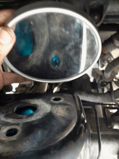

Got my shocks installed yesterday. Hoping this little something can help somebody.
These type of shocks don't have studs at the top like the factory struts, so you have to locate the holes first before you can throw the bolts on them. On top of that you have to align the reservoir bracket holes with the holes at the top of the strut tower and coilover top mount holes so you're doing this literally blind as the res bracket won't allow you much vision once you've placed it at the top of the top of the strut tower.
After struggling with the passenger side trying to locate the most outer hole by hand first, then trying to fish for the other 2 at the back by feel maneuvering the CO left to right front and back in that little space using a big pry bar cursing like a ****, using a small screwdriver to fish the holes and align the CO with all holes i decided something different for the passenger side.
Made an assault of the wife stuff looking for a damn mirror. i know i have one i bought from HF a while back but couldn't find the sucker in the mess i have in the garage, lol
With mirror on hand, place the CO in the tower and align one of the back holes, not the one in the front, with the strut tower hole, then jack from the LCA to pin the shock against the tower in that position, slap the reservoir in and align the hole at the back, then screw the 1st bolt loosely. Repeat the process for the 2nd back hole, and now the bolt in the front hole goes in like a piece of cake.
Sorry if this something easy for some, i'm not a mechanic by any means so bolting the 2nd coilover in place in about 5 min as opposed to 30 min to put the 1st one is the accomplishment of the year for me :)
49633092256_d8edc738b8_k.jpg2020-03-07_08-19-59 by RAM RSM, on Flickr
49633093121_784e25176d_k.jpg2020-03-07_08-20-23 by RAM RSM, on Flickr

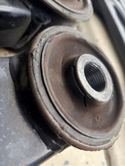

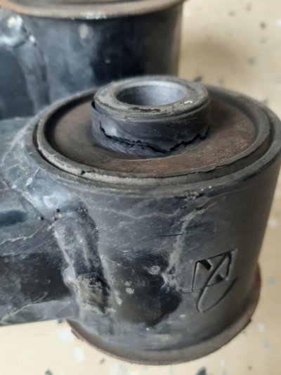

So i had the FO rear arms installed today.
Couple of things first. i'm extremely disappointed with Mevotech. I really thought they were a simple and nice option to go with. I've pointed out a couple of times this things were very nice because of the price and because they looked beefier than the stockers. This is how this POS Mevocrap arms look like after just 6 months. I did the install with brand new parts in Sep 2019.
Driver rear lower,
49664242851_068244a64f_k.jpg2020-03-15_06-12-59 by RAM RSM, on Flickr
I thought it was cosmetic without my glasses :), damn
49664529412_68c7ebfba1_k.jpg2020-03-15_06-13-17 by RAM RSM, on Flickr
This was the driver rear upper
49664531937_d8cf742fbd_k.jpg2020-03-15_06-14-14 by RAM RSM, on Flickr
Passenger rear upper:
49664532442_949f981694_k.jpg2020-03-15_06-14-27 by RAM RSM, on Flickr
So 3 out of 4 have cracked bushings with the first at the top being the worst, and that ones looks like that on both sides.

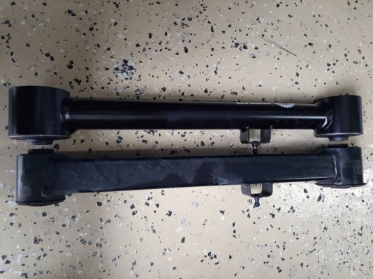

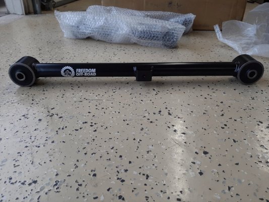

This is the FO rear upper
49660647877_4df5b34dc9_k.jpg2020-03-14_06-33-57 by RAM RSM, on Flickr
FO rear lower
49660367031_2e9fbbcc1d_k.jpg2020-03-14_06-33-47 by RAM RSM, on Flickr

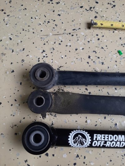

Compared to the Mevotech Supreme which i thought were more heavy duty than the stockers i replaced with 80k miles. Mevotechs above only have 7K miles lol, when the time comes to replace my front Lowers i'm going with factory Mopar LCA's without a single doubt in my mind. 87K miles and still kicking ******* butt :) knocking on wood.
Rear Lowers
49663700713_99fc2f42b4_k.jpg2020-03-15_06-10-48 by RAM RSM, on Flickr
Rear Uppers
49664525042_559180ec23_k.jpg2020-03-15_06-11-47 by RAM RSM, on Flickr

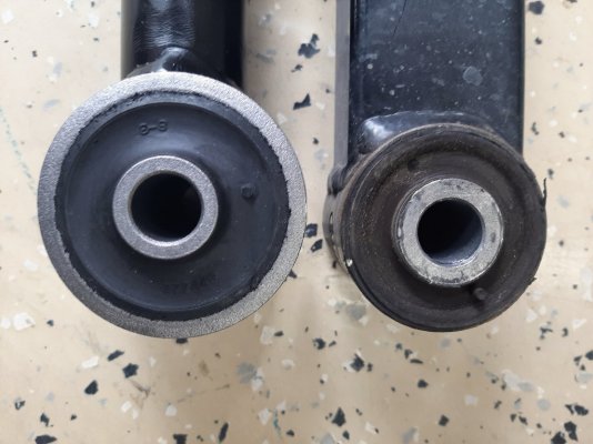

Big end of the bushing on the Mevotech is the same size as stock, and same size on the FO arms
The bushings appear different just in case, the Mevotech has a recess while the FO doesn't, so that gives me piece of mind is not the same bullchit bushing Mevocrap has :)
49664238856_17c6a99669_k.jpg2020-03-15_06-11-26 by RAM RSM, on Flickr
Big difference FO has same size bushing on the other end as well, while the stocker and Mevotechs have a smaller bushing
49664238361_1a64d730c7_k.jpg2020-03-15_06-11-14 by RAM RSM, on Flickr

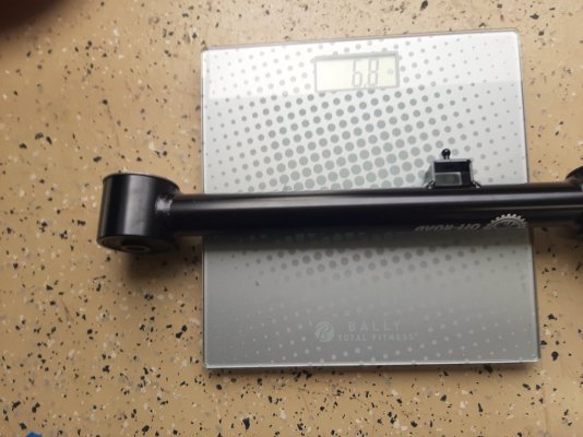

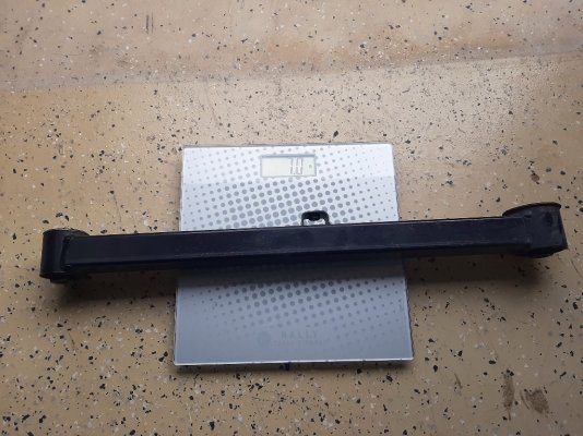

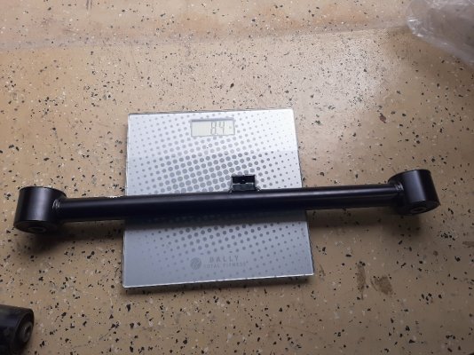

Then when it comes to weight, the FO's are heavier, specially the uppers compared to Mevotech.
FO upper weights 6.8 lbs
49664520802_6ba8500fe3_k.jpg2020-03-15_06-10-15 by RAM RSM, on Flickr
Mevotech uppers don't even have the weight to make the reading, and both upper and lower are a little heavier than the stockers go figures. I'd think they're about 4lbs or so as i think my bath scale doesn't register anything below 5lbs.
49664234251_d0d8928548_k.jpg2020-03-15_06-09-53 by RAM RSM, on Flickr
FO lower weights 8.4lbs
49664517047_e9e8833ef7_k.jpg2020-03-15_06-09-04 by RAM RSM, on Flickr
Mevotech Lower is 7lbs
49664232561_3a6b72e1a3_k.jpg2020-03-15_06-09-21 by RAM RSM, on Flickr

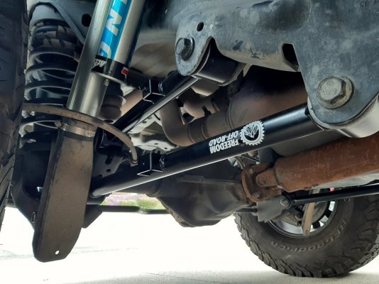

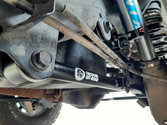

Product installed
49664248596_a7c126aaea_k.jpg2020-03-15_06-15-11 by RAM RSM, on Flickr
49664248231_3201f8fd1d_k.jpg2020-03-15_06-15-03 by RAM RSM, on Flickr

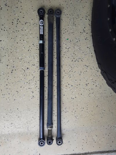

Also replaced the Bwoody Panhard with the Freedom Offroad one. Much easier to adjust because it's got a double slevee.
This is how all 3 look like, Stock, Bwoody and Freedom Offroad
49664249236_c5b0c0da84_k.jpg2020-03-15_06-15-27 by RAM RSM, on Flickr
Bushing view
49664536147_6c4813705a_k.jpg2020-03-15_06-16-00 by RAM RSM, on Flickr

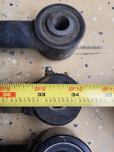

And some measurements:
Stocker is 33 5/8 eye to eye
49663716428_14b8966b78_k.jpg2020-03-15_06-16-48 by RAM RSM, on Flickr
I had the bwoody set at 33 1/2"
49664251861_abbd7d2f7c_k.jpg2020-03-15_06-16-32 by RAM RSM, on Flickr
and i've made the FO 33 3/8 perfect centering :)
49664251101_a1b1e1d197_k.jpg2020-03-15_06-16-14 by RAM RSM, on Flickr
Installed
49664539047_be3b9c9bfc_k.jpg2020-03-15_06-17-09 by RAM RSM, on Flickr
And because i know i'll forget how to loosen the nuts...
Thighty is down, loosey is the opposite :)
49663943678_342c884283_k.jpgFreedom Offroad Panhard Tighening orientation by RAM RSM, on Flickr
