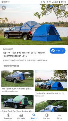

In my head something like this. Except you obviously have the soft topper. Almost like a tent condo! Plus those truck bed mattresses are kick ass.
If you could find one for cheap, which will eventually happen, than it makes sense to go RTT. But than you loose the soft topper which is a bummer, so you end up compromising on one thing or another. Screenshot_20191215-110345.jpg

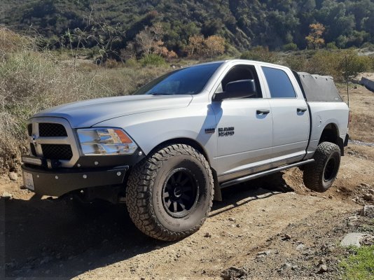

At the moment still amazed at how this truck respond to suspension/tire mods.
84k miles and counting :)
49223571317_460a1068fa_h.jpgUntitled by RAM RSM, on Flickr

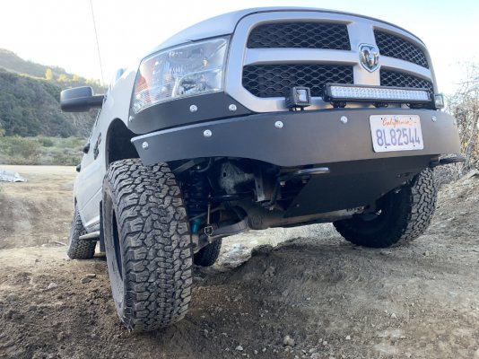

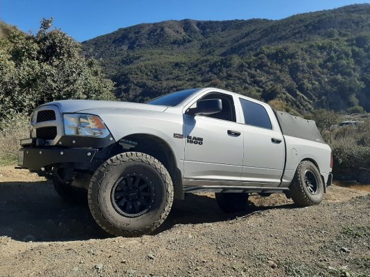

Stretching her legs locally before the end of the year. Big Bear is packed with snow and mud, same with Cleghorn or Pilot Rock and my brother in law was in Johnson valley couple of days ago and they also had snow and lots of mud. With nothing around to clean that mess afterward quickly, i can't stand the idea of driving couple of hours letting that stuff cake up and dried, lol i hate mud.
So just to take it easy
49306394603_6208f278eb_k.jpg20191231_124456 by RAM RSM, on Flickr
49306393948_601734d652_k.jpg20191231_125042 by RAM RSM, on Flickr
49306892301_874506686c_k.jpg20191231_122137 by RAM RSM, on Flickr
49307097892_df37667ba3_k.jpg20191231_122056 by RAM RSM, on Flickr

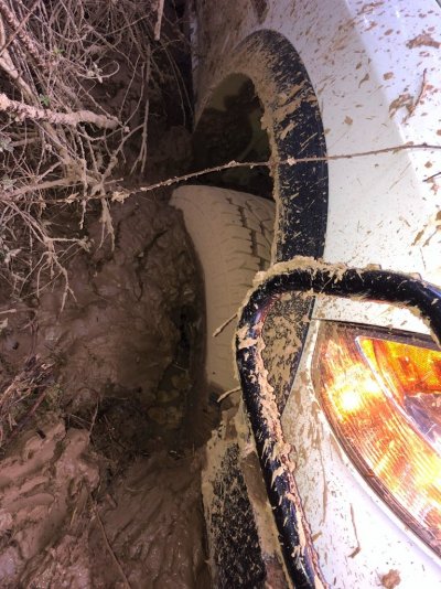

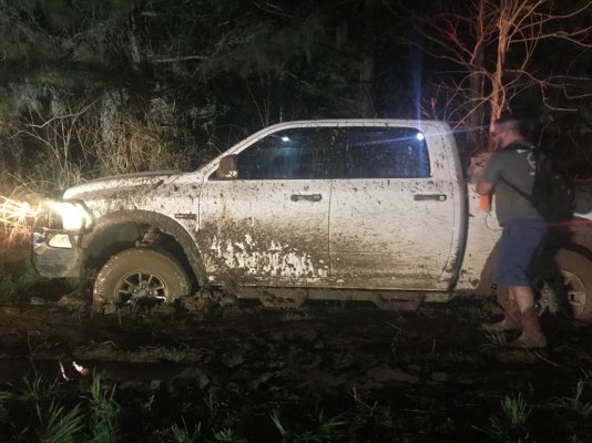

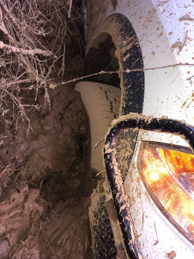

Wow. Would’ve been good to know when I did this:
One of those instances where larger mud tires and mechanical LSD or lockers will had faired better for you. BLD would have not saved you from that alone as you want momentum and wheel speed to sort through something like that. I don't know the details/conditions of the spot where you got stuck, i'd imagine myself in that situation trying 4hi and lots of gas before entering the mud pit :) from the pic it seems the truck is high centered on the diffs so not a lot you can do once you get to that point.
BLD works better in this type of situations where at least 2 out of the 4 wheels have something to grab on, you don't have to wheel the vehicle like you will with an open diff, just keep your foot in the pedal even if the tire is lifted in the air, smooth and steady throttle and the system does the rest.
