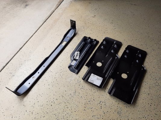

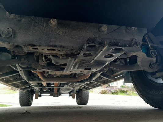

Got some Mopar skids laying around and the boredom from the Corona chit got the best of me.
I wanted to close some of the openings i had in the truck belly
49740795601_b9a5846f31_k.jpg2020-04-05_06-37-54 by RAM RSM, on Flickr
49796005062_ab54a49f53_k.jpg2020-04-19_07-09-45 by RAM RSM, on Flickr

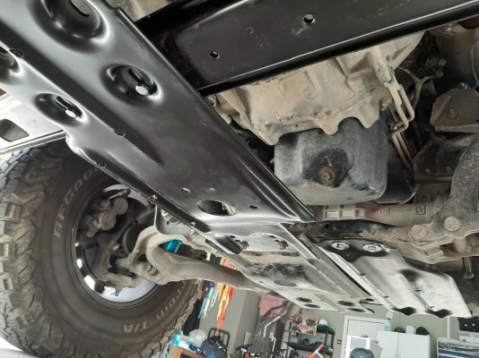

The transmission is a little more protected now, Though the mopar crossmembers are not exactly heavy duty, but at least better than nothing for now.
49796005052_02f8da7494_k.jpg2020-04-19_07-09-56 by RAM RSM, on Flickr

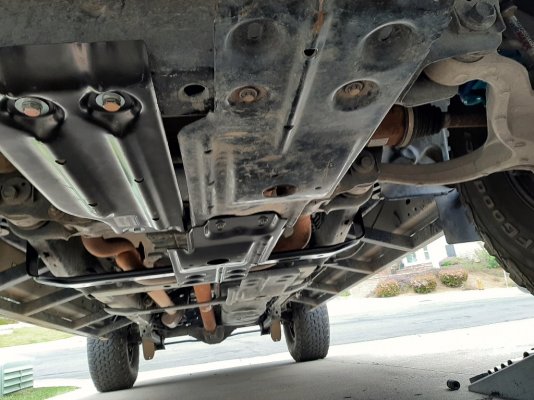

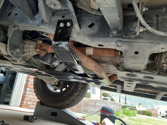

The exhaust pipe seems stronger than the crossmember so worst case the lip on the skid will stop there.., hopefully.
49795702866_fc180509a0_k.jpg2020-04-19_07-10-31 by RAM RSM, on Flickr
49795713576_553a07520e_k.jpg2020-04-19_07-14-17 by RAM RSM, on Flickr
49798603188_4c7cd5bba8_k.jpg2020-04-20_01-59-27 by RAM RSM, on Flickr
Once we get out of the quarantine i'll ponder some more with it and go steel or aluminum plate shopping.

Yep. I used the crossmember that comes with the TC skid and bolted it to the frame so the skid lip could rest against the exhaust pipe . The other end mounts to the oil pan skid, same bolts and everything i just had to shave a small portion on the new skid so those 2 ends could sit flat right there.

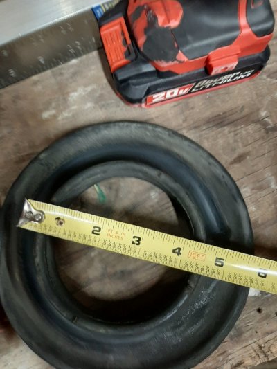

So i've been doing some more digging looking again to get rid of my Daystar spacers and the JT aftermarket might be the answer one more time. I stumbled on a couple of pics i saw with the JT rear springs from Clayton and the resemblance with my Icon springs was so much i started checking videos and more pics thinking ******** they look like they'll fit.
https://www.claytonoffroad.com/product/jeep-gladiator-25-triple-rate-rear-coil-springs-2020-jt
So i just ordered Clayton 2.5 rear coil springs for the JT, the dudes at Clayton Offroad are just amazing. Not only they list full specs on the stuff they make, i asked them if they could measure the lower opening on one of the coils to see if they'll fit the lower spring perch on my truck, and 5 min later i got their response.
Our coil print shows lower opening should be 2.53 +/- .062
Top is 5.060 +/- .062"
They also said I'm free to try them in the RAM, only thing they asked was just to cover the shipping back if they didn't work, but they'll wave the restocking fee. More than happy to try and test them :)
I'm hoping they'll work out, i can't believe how close they're in measurements to what we can fit in our trucks.
I measured my lower Icon perch Icon opening and it seems 2.5"
and on the top side, this is my factory coil rear isolator, so it seems 5" where the spring will seat. more than excited to give this puppies a try.
