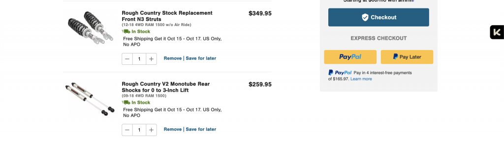

The current shocks and struts are worn and my stepdad confirmed to me that it's better if I replace them. Also prior to asking his opinion, I noticed it was bouncy it's not comfortable on most bumps like before and the right strut is leaking last I checked. I am nowhere near your experience I am still learning as I go so correct me if I'm wrong but when I turn the wheel I do hear a thud of some sort and it was the same when one of my previous cars that had bad struts it sounded quite similar to it. They weren't in great condition when I bought the truck but the roads in my part of Ohio definitely are rough on suspensions. I was thinking of getting the OEM shocks but I also saw these which are more expensive than the Mopar ones I read reviews about how good they were and I would like to know your opinion and ill attach a screenshot of the Mopar parts if I added to cart the right ones.
Americantrucks links:https://www.americantrucks.com/roug...stock-replacement-front-n3-struts-501097.html and https://www.americantrucks.com/roug...be-rear-shocks-0-to-3-inch-lift-760738-k.html

I haven't use the R/C's. Hopefully others here can provide feedback on them. Rough Country has been around for a long time. The V2 rears are mono-tube which can be a bit stiffer ..just by the difference in technology. Mono-tube's do last a long time though and are great for off-road. On longer drives, a stiff shock can be fatiguing. Make sure whatever you order, the new shocks are for stock-height (not for a 'lifted' Ram), unless yours is lifted or raised.
All shock companies claim their particular product will improve the stock ride, is superior technology, heavy-duty, and a bunch of other buzz words. It's easy to get caught up in different company's marketing claims. It's virtually impossible to get a good sense how a particular shock will ride compared to another company's shock absorber or even from one user to the other. One guy may have soft side-wall tires, another may have 10-ply tires with high air pressure. That's the frustrating thing about buying new shocks. So hopefully you can get other feedback.

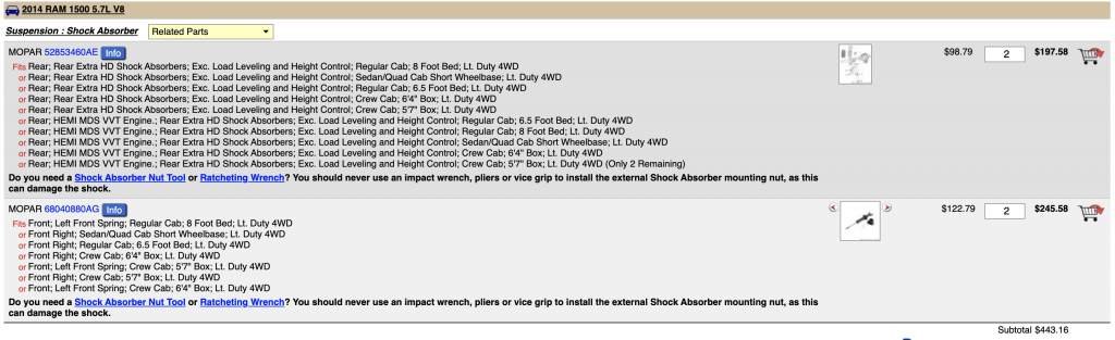

I have searched with the barcode number on my shocks and struts. For the rear shock absorber on my truck, I got this barcode number: 52855791AC. I found only one on rockauto and for the struts barcode: 05168508AC I can't find any part in rockauto matching it. Does anyone have an idea of what should I do? it is my first time using the part number to order so I'm sorry if it is a dumb question.
Mopar part numbers for the same items will change over the years. i think the part# for the front strut is now 68170199AC, while the rear shock is 68216985AC. Call the dealer to confirm with your vin number. Also we have a Mopar vendor in the forum as well https://www.ramforum.com/forums/all-mopar-parts.133/
He goes by Benny and he can check what you have with your vin number as well and get you factory parts at a better price that if you walked into a dealer.
Also If you want OE replacements non mopar, Gabriel, KYB and Monroe have quick struts and rear shocks as well. Lot of people swear by KYB.
