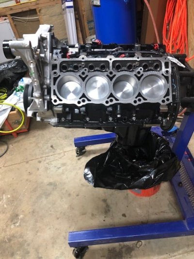

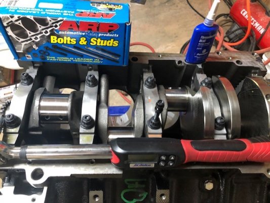

Planning on starting on the motor this weekend. Being it's a stock bore and stroke motor and not a larger displacement as the Hell Cat, I'm calling it the Hell Kitten. ;)
Ordered A ATI 6% OD Super Damper that should arrive tomorrow. Also the ARP main studs should be here next Tuesday.
I'll be breaking the motor down and start gapping the rings to specs on the MMX forged piston & rod drop in kit. If the Cam makes it in time, I hope to have the motor ready to drop in over the 4th of July weekend. I'm looking forward to this!!

Premium Hellcat main bearings with ARP main studs. Stock crank. Stock bore & stroke.

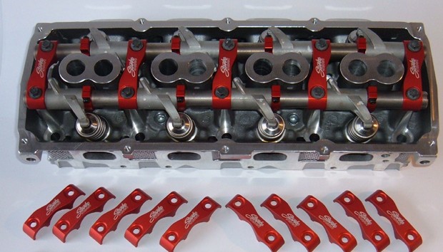

Have you considered a set of rocker shaft stablizers. I'm running the steel versions from Mopar,but Stanke builds similiar versions in aluminium that are slightly cheaper
No I have not, good suggestion! Steel would seem to be more durable. How difficult was it to trim the stock valve covers? Or did you go aftermarket on the covers?
Thanks!
Jan 17, 2016
23,853
54,914
14 Sport
Thanks!
Stock covers.The Mopar versions come with a template for the trimming required. They weren't very hard to trim,it's been about 7 years since i did them,but if i remember right it took about a 1/2 hour to trim them with a Dremel and sharp exacto knife.
I contacted Mopar online performance about these and they asked for a vin #. They said these wouldn't work on my Ram and they were for Chargers and Challengers. WTH! Uninformed sales rep?
Jan 17, 2016
23,853
54,914
14 Sport
I just tried ordering from the link above,and they never asked for vin#
That's why I like to check around. Some people (parts dealers, not you) know their stuff and some don't. I know they will work because your using them!!
They've been on my truck for about 6 years . You might say i've been a guinea pig for a few years,lol
