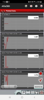

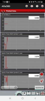

Using alfaobd I did a injector pulse graph
On acceleration 8 goes to 0

fairly easy job to swap out an injector.
Ya need to pick it up today and swap it out. I'm hoping that will be the last of it. The plugs and coil pack helped

Just got the new injector in. No more misfire CEL. Still runs a little rough but getting better w driving it.
Fingers crossed brother, just maybe you will be the lucky guy I was talking about in my first post. I think it is still a longshot, but I will be real happy to hear that worked. The test will be on a long trip when you get that oil hot.
