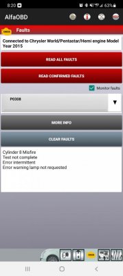

So now only reading P0308? No other codes? And running shaky? The usual suspect here is the cam/lifters. I wouldn't be doing any long trips til it is fixed.
It doesn't shake all the time under 2-3k then evens out but not constant

New coil pack, spark plugs and injectors. The p2099 went away. I need to check the o2 sensor. I did a % chart on alfaobd for on sensor 1/1 and 2/1 but chart did not produce any results

Not tossing parts. I use alfaobd to diagnose the issue which was the misfire p0308. Replaced all plugs. Did not remedy. Replaced coil and injector. Helped immensely still an issue. Not as bad tho.
