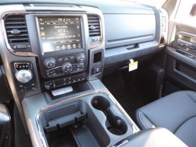

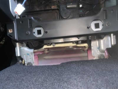

Just installed a center console in my '17 this weekend and ran into a couple snags, probably because the console I got was from a '18.
But first thing is I have an extra connector coming from the console, not sure what it is for, I'm thinking heated rear seats, but the plugs underneath the rear seats have more then two wires, so I thought it'd be wired for it.
View attachment 181930 View attachment 181931
Also is there different radio bezels for the old style and new style consoles? I have a little gap at the front of my console between it and the radio bezel, like it doesn't contour correctly to the radio bezel.
59346-e2b4c66e6c5de2471bfe16bdeafe7cd5.jpg caa56748-69d6-4395-a9d1-0a1f2b7531cf.jpg
Can’t help you with the plug, but are you sure you have the center bezel and the center console trim are snapped all the way? I had the same problem and one of the tabs was not snapped all the way on the bezel.

I checked some wiring diagrams and looks like that plug is for heated rear seats, I don't have the module under the front seats for it.
As for the gap I'll double check this weekend if everything is together right, but here it is, idk maybe it's normal. Just seems weird that it's tight on the outside and I can almost put my finger in the gap towards the inside. I know my 2011 that I put a console in didn't have a gap like this.

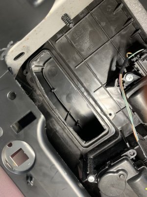

Thanks for all the info from this thread. I successfully swapped a bench seat to a center console and added rear a/c ducts in my 2013 quad. On that note, anybody want a jump seat? Lol
does anyone have pictures of having to cut into their non-rear duct work to add rear air? Also I’m a little confused on the air duct part that I need to add. I have the front support member with the air duct on it. What part do I need to get it from the dash air ducts down the the front support member? Thanks, any help would be great!!
SRich2015
Jul 23, 2017
269
119
USA

I wouldn't think you would cut into your box but would need the part that directs the air to the floor. I can't tell from your picture but there must be a piece that come off and you add another piece.

Wanted to post some pictures from me adding rear air. You have to cut into the box to remove the piece that will allow you to use part# 4. Other than manipulating that part in, it was pretty easy. Should have it done next weekend

Well I was wrong, you do have to cut the box!! Glad you got it figured out!! Look good!!
