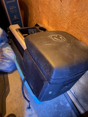

I did the reverse swap a while back so if anyone is looking for a console I have one from a 2015 bighorn
Just sitting in my shed , guess I should list on eBay at some point .

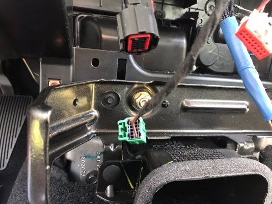

Well this weekend I finally had enough nerve to cut into the lower air box and install the rear air and center console. Thanks Benny and all the rest who gave me the information. 3eb9eb210d308c42bec1a90a564c5db4.jpg916442dc91bc8b29aa112a5bc93e72c1.jpg8912e6c0b6ab5b92f9674962d29389fb.jpg891dd0232bee1db762c4825534033e89.jpg
Lol I'm contemplating cutting mine open tomorrow as I have my jump seat out and floor console ready for install, how hard was it cutting and can you feel the air comming out of the rear.

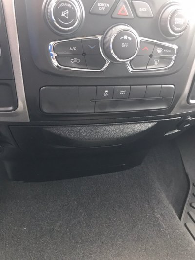

Screenshot_20200117-191719_Chrome.jpg IS THIS THE SPOT THAT WOULD NEED TO BE CUT OUT TO HAVE THE REAR HEAT WHEN INSTALLING THE FLOOR CONSOLE

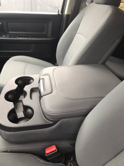

I picked this up today, there’s no vents, would my 2017 SLT truck need to alter or add additional hvac vents or would my existing ones work?
SRich2015
Jul 23, 2017
269
119
USA
You will have to get the rear piece with vents and the ducts.
