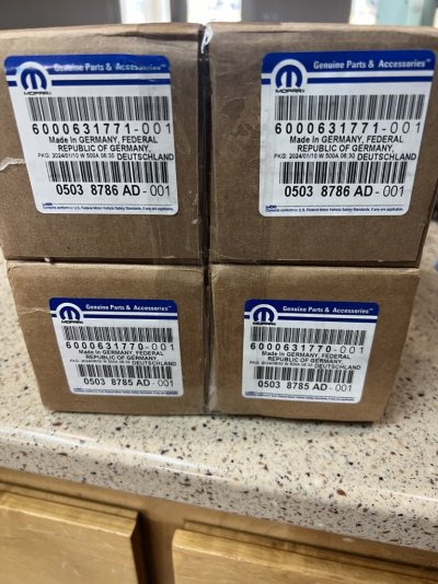

Hemi brothers, do these look like the real genuine packaging?

I also have a set of those lifters coming from E-Bay. Seller swears they are genuine - but how can they sell 2 fronts and 2 rears for under $400? That is less that half the cost from MOPAR.

The ones I recieved have the same laser etching as my originals and came in sealed boxes that appear to be the same boxes others get from Mopar. I believe mine are real but I’m just as astonished as you because the Mopar website wanted $1200 for the same set.

Those lifters packages look legit. The lifters will have some didgets etched into them as well.

Thank you for reassuring the lifters appear to be real. The etching on the lifters matches the originals. I’m happy I only spent $500 vs the $1200 from the Mopar sites.
