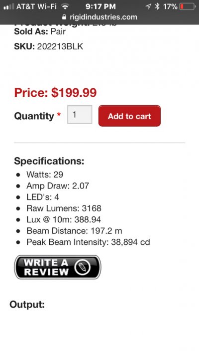

Ok fellas maybe someone can give me some insight....below is a picture of some custom lights using rigid dot pods . They were wired into the factory harness for the quad lamps my truck came with
I hooked them.up to the truck and they worked fine when the truck is off. Meaning when I unlock. Truck the headlights turn on and when I turn on headlights via the knob when truck is off they also work.....

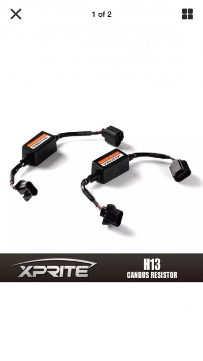

However once the truck turns on they flicker and turn off and intermittenly flicker and then stop working all together ..... So I ordered some cheap canbus resistors as pictured
They seemed to work well for about a day or two ... Here and there they'd shut off but would go back one immediately after so I was ok with that... But then last night they shut off completely and won't work....
The plug that come from my truck into the headlight harness is an h13 style plug ... So that's what I need to make em plug and play with whatever resistors/capacitors I need. It's just finding the right combo I'm guessing... Any ideas out there would be greatly appreciated!!!! Below is a photo and specs on the specific pod being used for low beam .
