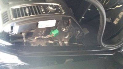

Does anyone know what each wire is?
I know theyre for the dome lights but im trying to tap into one to add in lighting in the truck bed

LAMP-DOME-REAR
Harness Family: Headliner_RT
Cavities: 11
Color:
Gender: FEMALE
Part Description: 7123173630
Engineering Name: DOME_LAMP_REAR_NON_SWITCHABLE
Connector No: D4525A
Option: Standard
Pin Circuit Wire Color Gauge/Size Function
1 M27 YL/LB 0.8 READING LAMPS DRIVER
2 M11 YL/VT 0.5 COURTESY LAMPS DRIVER
3 Z910 BK 0.5 GROUND
