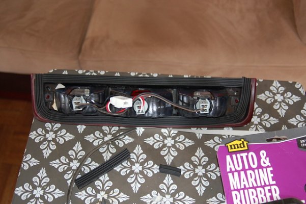

It is the easiest fix in the world, it is however hard to believe ram never fixed this in manufacturing. Anyhow, get some of that 3m stuff done, mine hasnt leaked since. You can easily see why they leak, the seal is a joke compared to the fix.
Notice how the material needs for follow the curves, it has to be done this way, think of this picture upside down. The straight piece that follows the bottom needs to be on the inside, or it can leak.
That what I used after my 3rd seal failed...
