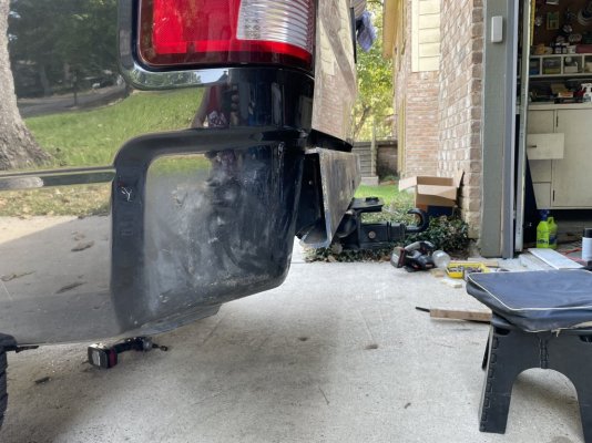

IMG_6164-compressed.jpegIMG_6165-compressed.jpegIMG_6166-compressed.jpegwe had a roll off dumpster in our drive way and i backed into it. straitened it out some but it gave me a good reason to try to build one.
i went to the steel yard and got a length of 2x6x.25 and started fitting it up. this is what i have so far. id like to remove the hitch but i tow my boat to the river occasionally.
as time and finances allow i will add end caps that curve around the sides a little. also have to rig my sensors and plate lights into it.

i had a coupon to advanced and got herculiner liner. it went on nicely.
