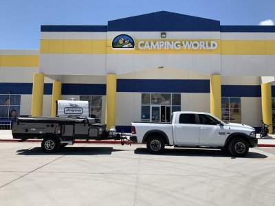

How much did your truck sag when the trailer was hooked up? Any picture by chance?
Worst case scenario would be airlift helper bags. But I doubt you need it.

Mine also has the air suspension that does automatically level the truck; so it didn't sag at all, but I wasn't sure if that mitigated the front end getting light, or not. I know I probably am being a bit paranoid, but when you're new to towing/hauling and you've got a beautiful little 4 year old daughter in the backseat, it makes me want to hear from people with more knowledge that I am good to go.

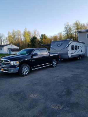

This is mine:
I got XL rated tires on it, and Timber Grove air springs. Stable towing and safe. I had the same concerns as you did when I bought the Ram and the camper. Asked a lot of the same questions. My family and puppers in the truck and everything else loaded up in the camper. I'm not close to GVWR of the camper and I'm only about 400lbs heavier on the camper.
Much rather ask the questions, than have something stupid happen on the road. I've seen enough dumb s#!t happen to know to ask.
