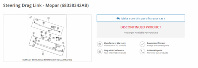

He aint kidding. This is the part I ordered about a month ago. Paid like $130. Wonder why its discontinued. Hope there isn't something wrong with these that we don't know about.

They changed it to a "AD" suffix. I'm 99% sure the only reason it changed was because they changed the years the part fits. They now actually show it fitting all the way back to 2013 where the AB model was 19-20 only (even though we know it fits). It's pretty common that they do that. Of course they also raised the price in the process.

Phew, I literally just installed this last week. Kinda freaks you out when you see its been discontinued.
FWIW I highly recommend changing to this design for anything bigger than a leveling kit on a 2500. The lift I installed wanted you to take the original drag link off, and cut some tab off in order to rotate the end that goes in the pitman arm 180 degrees. This one you can flip it around with out cutting.
