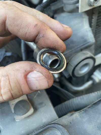

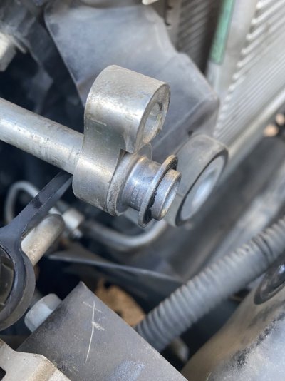

I just noticed these. Lube and use again or is this some oem part I need to get? I have green o rings but this washer and rubber inner edge looks like its all one part.

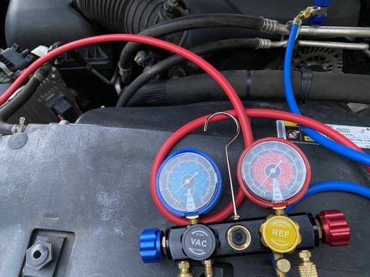

Ok, new condenser in. Replaced both of those washer/o-ring things on the lines. Vacuumed down with a pump 15 min. Stayed at -20/30 (last pics) for 15 min.

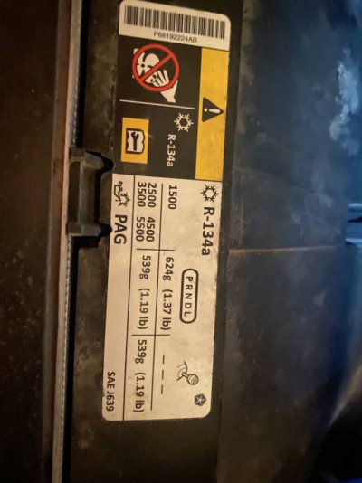

recharged. And blowing at 50 degrees at the vents. But……did I overfill? I did one 12oz can and a 1/2 (or little more) of another. Trying to calculate 1.19lbs into ozs. Then I took an old charging can with the built in gauge on top and low side was where I showed the mark on the pic. Advice? Thanks everyone up to this point.

Morning after update: I walked out this morning, did not start truck. Stuck the cheapy r134 can with gauge on low side for reading. See pic 1.
then I put good gauges on low and hi side. See pic 2. Lastly I started truck and thats pressures on the last pic. Am I overfilled or ok or ??? Thank you. Its still blowing 50 degrees at the vents.

Tach_tech
Jun 1, 2014
3,320
3,595
5.7L HEMI
What are the high/low side readings with the engine running and A/C on? A/C systems are charged by weight so pressure readings only get you in the ballpark but you need the running pressures.

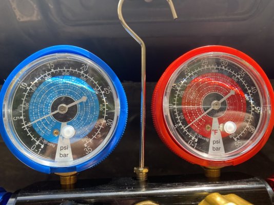

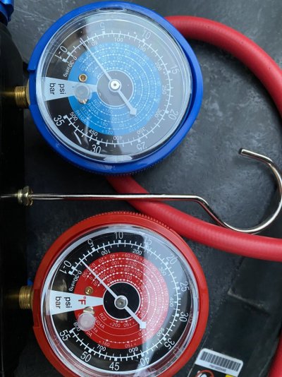

About 40 low side and 20 high side. See pic. That’s running.
Tach_tech
Jun 1, 2014
3,320
3,595
5.7L HEMI
With an ambient temp of around 21C/70F you should have low side pressure of 20-30psi and high side of 150-250psi. Your high side pressure is way low. Usually the only time high/low side pressures are equal is with the system not running or the compressor is not working. You could still be low as well. Your system capacity if it’s 134a is 1.19lbs/19oz.

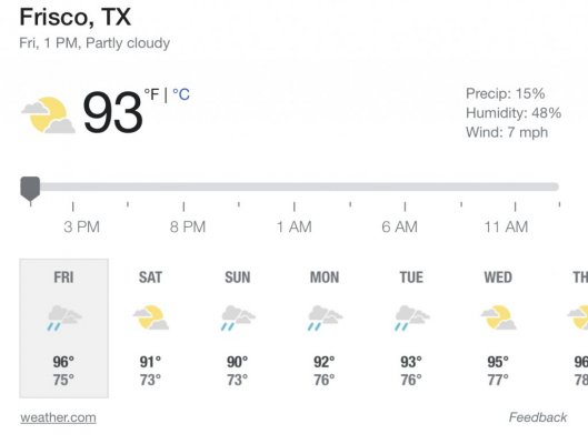

Thanks Tach_Tech.
Its 93 degrees here now. 48% humidity. Hot outside in Texas.
I used one full can of this with leak dye, and there is barely any left in this 2nd can. So almost 24ozs. So you think add more?
I let the truck run about 10 minutes. Checked with gauges. 50 on low, 50 on high.
Still blowing 50 at vents inside. Thank you.
