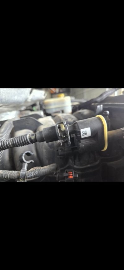

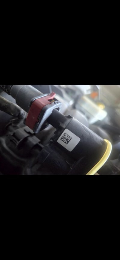

I'm trying to replace my purge valve and I cannot figure out how to get one of the connectors off. I'll attach pictures. It had ared safety clip that I removed and now it seems there's a white clip that's holding onto the line. It's the connector on the same side as the electrical connector .

Usually clips like that slide up, in the last picture does the white clip go all the way across? If so there should be a way to pry that up.

Yes it goes around, almost like a c clip. I'll try a screw driver. it almost has like teeth on the ends so at first I was trying to pinch it but maybe I need to spread it and then pry it up

Put the red piece back on,but only to the first stop,squeeze it's sides so it grabs the first step of the white connector,then push the red connector on farther to release the white connector

Ok, I'm probably doing it wrong but the red piece just keeps sliding over and clipping back into place. do you know what type of connector it is so I can look up a picture or video ?

Once you remove that red safety clip you push down on the top of the white clip while pulling it towards the purge valve, then pull the hose towards the firewall. kinda like a Chinese finger trap while pushing on the white clip.
