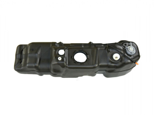

I have read about some people removing the charcoal filter
emptying it out & putting fresh charcoal in it
But if it is the gas tanks vent/rollover valve, i don't know if there is a fix
Think about it, the tank has to be assembled, why can't the the vent valve be replaced ??
Look at the white round fitting at the highest point on the tank
I believe that is where the over flow & every other valve is

I have the same problem........if you search the forum someone posted a how to remove the spring in the rollover valve to correct the problem .....
