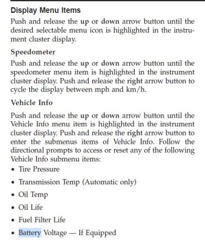

So, I just got in my truck to go to work today and I looked through the EVIC display screens and I didn’t see anywhere where it showed a digital read out of what my current charge voltage is so where is it at?
All I see is the big digital speedometer, the screen set up screen, the stored messages screen, the audio screen, trip A and trip B screens and the fuel economy screen and when you go to the vehicle info screen, all that shows is the tire pressure, the current state of my air suspension, transmission temp, oil temperature, oil life meter, engine hours and the gauge summary which only shows a digital readout of coolant temp, trans temp oil, temperature, and oil pressure.
I think the EVIC on the diesel equipped trucks have this screen, but I don't think i've never seen it on a Hemi equipped truck.
You can use a multimeter across your battery terminals while the engine is running, or you can monitor the realtime voltage output using live data from AlfaOBD or a Bidirectional scanner.

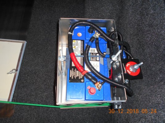

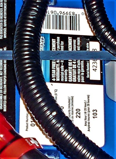

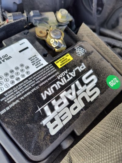

So how long have you been using that AGM in your Ram? I’m not so sure I wanna use one now being that I’ve been doing some reading that says I shouldn’t use one unless my vehicle came with one.
I've had the same big ole Group 31 AGM in my truck since 2017,and it was still starting the truck perfectly fine and passing a toaster test load test when i sold the truck a bit ago.I never touched the charging system in my 14 ,to use an AGM battery,and the group 31 is quite a bit more battery then the little factory H7 battery is.
This is the battery that's been in my truck for 8 years.I do use a Noco charger to keep it topped up when the truck is parked for the winter.I also have 2 master disconnect switches,the bumper mounted one shuts the truck down when it's running to be NHRA legal,the one on the battery box kills everything,if the trucks not running,but won't shut the truck down if it's running,should slow up any thief,lol

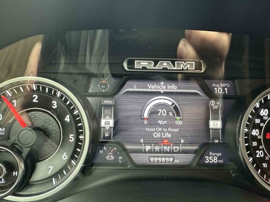

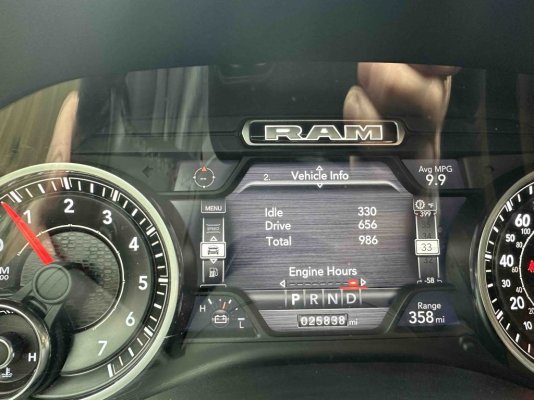

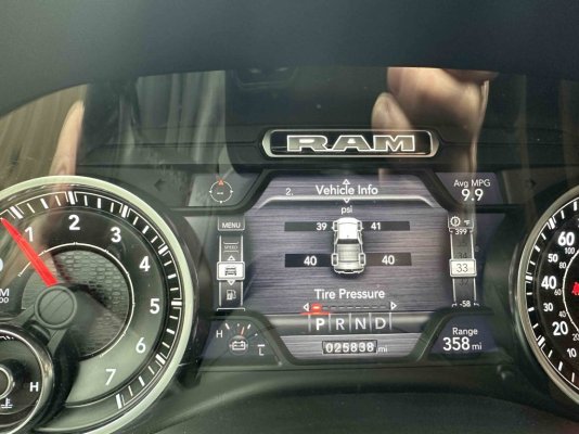

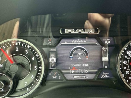

OK, Here U go: On yer Limited you have THE 7" Premium EVIC Screen. Here is the screens you should see: Start at Big MPH Screen. Hit Left side steering wheel (SW) controls down (1), then you will see whatever screen was previously viewed. Scroll left/right till you see Gauge Summary displayed. Now you go (1) to the Left and you should see: Battery Voltage. I do not have the order exact as I had to shrink the pics size to a viewable segment on my other PC, as I do not have a viable program on this new PC I am on now: But as you go right/left you will see the screens depicted below after you go down (1) from MPH display.
ADDED: Just FYI: When you first get in truck and start and look at Trans Temp: You will see it will be almost the same as the outdoor temp displayed in your Temp on your UCONNECT screen (I just do not know how far down it defaults to display to, ie., how far down temp it will show till hits default).
Battery Voltage.jpgCoolant Temp.jpgEngine Hours.jpgGauge Summary.jpgMPH.jpgOil Life.jpgOil Pressure.jpgOil Temp.jpgTire Pressure.jpgTrans Temp.jpg
Out of 2018 Manual: Since Limited, but still Gen 4, I would think it would have battery info displayed-equipped: Pics above from my 2019 5th Gen:
View attachment 558986View attachment 558987View attachment 558988View attachment 558989View attachment 558990View attachment 558991View attachment 558992View attachment 558993View attachment 558995View attachment 558996
I guess that’s a new body style thing or like that other guy was saying, something that only the diesel trucks have but, I went through my screens this morning before I went to work and I don’t have anything on there that tells me what the charge voltage is using actual numbers. Sounds like the only way I’m gonna be able to do that is to hook my laptop up using Alpha OBD while I drive or just plug in my little bitty OBD 2 scanner and see what it is that way.

I’ve been reading all over the place, not just here where people claim to use these AGM batteries in a car that did not come with this type of battery that say they’re not having any problems. Or in other words, their car doesn’t know any difference from the AGM battery to the Regular ole, cheaper battery the car came with or what they’ve used all these years.
That’s what I meant about people saying they haven’t had any problems.

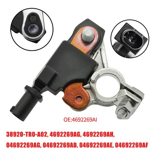

Sure, if there is one, but this is the 1st I'd seen evidence of one. No one associated with the vehicle could or would tell me.
Take a look at your negative battery post Brian,or better yet get us a picture of it,if it has a weird looking connector,that'll be the IBS /intelligent battery sensor ,and as far as i know it was added in 13 to the majority of Chryco vehicles.
If you have something that looks similiar to this on the negative battery post,you have the IBS sensor
