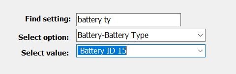

Sure, if there is one, but this is the 1st I'd seen evidence of one. No one associated with the vehicle could or would tell me.
I sent an email to Alexey, asking what he knew about the Battery ID 1-15.
He said he had no information but would poke around to learn what he could.
