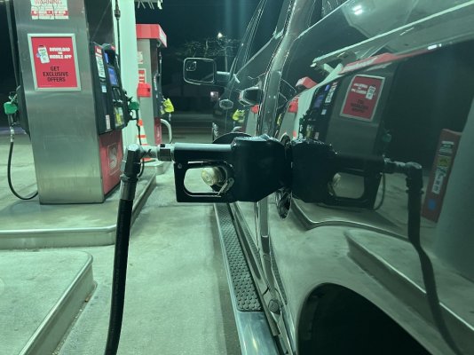

I just want to say thank you to this thread. I brought my truck into my local dealer, told them that I am having a hard time putting the gas nozzle in at gas stations, and sometimes it is almost impossible to remove the nozzle after filling. I brought the replacement neck tube part # and they did the swap. I also let them know I did NOT have a problem with the nozzle clicking off during filling. It was coved under Maxcare...
Here are a couple pictures AFTER I got it back and when to fill the gas.
Here is a video I made to send to my brother (he has the same problem with his '18, but also has the problem where it clicks off during fill)
The bad news, when they were replacing the filler, I think the mechanic stretched the fender liner over the bed arch. The paint got rubbed off to the primer right at the lip of the arch. I brought it back yesterday and they are going to send it to a body shop to repair.

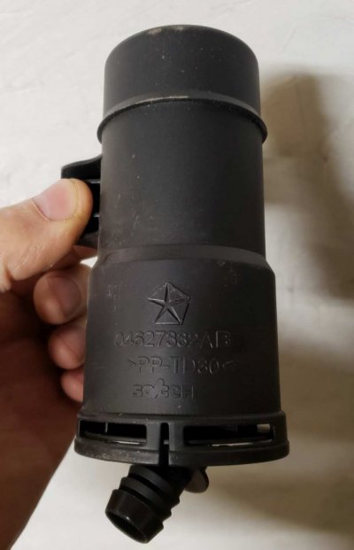

I had the problem several times in the 440,000 km now on my pickup - 2014 RAM 1500 Hemi 5.7 and discovered what a simple fix it was.
There is a small inverted canister about 2.5" diameter x 5" long with a small hose attached secured under the box beside the fuel fill pipe.
That canister has a paper filter in it that will get plugged over time, sooner if you drive dusty roads.
Then if you drive in wet humid weather, or if you wash underneath the truck - (I have a 90 degree nozzle to wash under body thoroughly from road salt), the paper filter will get wet and the dust in it turns to mud and then hardens. When filter is completely plugged you have the effect that everyone complains about - unable to fuel up at more than a trickle.
I have purchased twice but didn't like the price so the last time I pried it apart and gently washed and rinsed the paper filter, air dried with blow dryer and then reinstalled.
That's as simple as it gets but was frustrating until I figured it out.

Thanks for the information. I just looked up under my truck and see that canister up there. It's just zip tied in position. If I take that down and remove it, should I expect a face full of gasoline? I've had the filler neck replaced, but occasionally it's beginning to give me fits if I fill it at a high rate.
