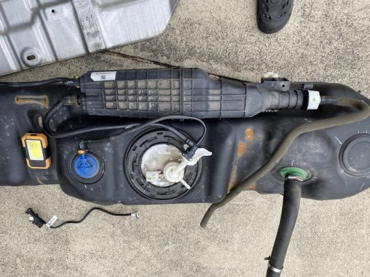

Thanks, thankfully I have a second vehicle I can drive while I tinker with my truck! Did you have to drop the tank to replace the evap canister?
I replaced everything at one time after I removed the old tank. I’ve read and it certainly looks like you can replace the evap canister without dropping the tank. Look at the second pic above and you’ll see that it only has three hoses attached and one electrical connection at the white plastic end. All connections can be reached with the unit on the gas tank. You will need to remove the heat shield from the gas tank. Four spring metal press on clips that can be gently pried off and reused. The heat shield then just slides off toward the driveshaft. Gives you a clearer picture and easier access. If you message me I can give you the name of the parts supplier I used. They are CJDR dealer and have great prices with low shipping. Not sure if the forum rules allow public posting of merchants.

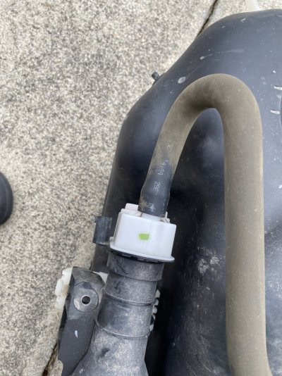

In the first pic you can see the white clips on the tank as viewed from above. The second pic you can see one of the white clips and how it attaches to the canister. The second clip is not visible in the pic but it releases the same way. The third pic are the hoses at the one end of the canister which release by depressing the two release tabs on the locking ring. The last pic shows the hose connection to the multifunction valve and the electrical connection. The hose pulls off and the electrical connection has a push tab that is in an awkward position so you’ll most likely have to remove it by feel only.
