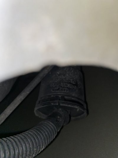

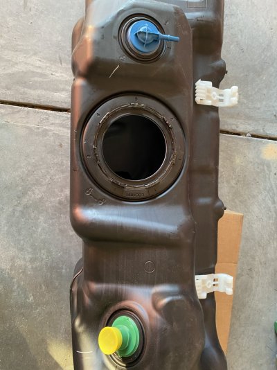

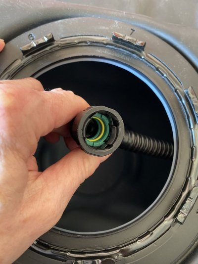

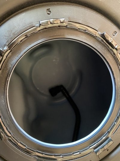

I’ve been thinking about the rollover valve and I’m not convinced that any change to the valve would make a big difference in fueling the vehicle. I removed the spring on my old tank valve but still had fueling issues. When I removed my old tank the rollover valve was open due to the removed spring. That leads me to believe the valve wasn’t slowing the flow of fuel. If you search YouTube for Boosted Mororsports the guy has a 5.7L fourth Gen Ram 1500 and he changed out his fuel pump because he supercharged his truck. I followed his tank removal instructions but I found on my tank I have a hose inside the tank that attaches to the fuel pump. I’ve attached pics for you to see. I assumed the difference in the tank/fuel pump was because I have a 3.6 Pentastar BUT the tank I used for my replacement shows fitting both the 3.6 and 5.7. Boosted Motorsports did not show in his vid any internal hose connected to the fuel pump. This hose appears to be connected to some sort of vent. I’m thinking this is the problem. I wonder if anyone knows how these things work.

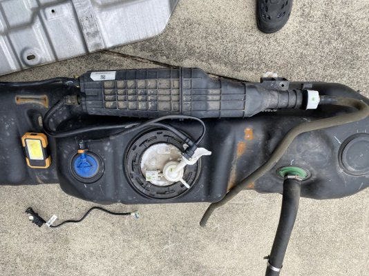

Atcer2018, is the charcoal canister located on the filler tube inside the fender? I've had problems filling the truck the last two times but have always had to play with the nozzles since I bought it! The last two times have been squeeze, click, wait, repeat! took me 20 minutes once to put in 15 gallons, this morning I stopped at 3 gallons because I was heading to work.

Same here, took 27 minutes to get 15 gallons in and that was all I could take in winter and I live in SE VA where winter is 50F lol. The evap canister is mounted on the gas tank facing the passenger side. It’s long and thin as shown in the attached pic. I believe the thing you’re talking about is the Fuel Vapor Canister Vent. It’s located alongside the fuel filler neck and can be accessed by removing the driver side rear wheel well liner. Looks like the third pic below.

Thanks, thankfully I have a second vehicle I can drive while I tinker with my truck! Did you have to drop the tank to replace the evap canister?
