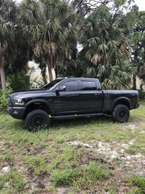

2018 Powerwagon!
For those who dont know- this means:
Ram 2500 CC SB SRW 6.4 Hemi 6 Speed-AT
Lockers front and rear
Disco Sway Bar
Warn 12k Winch
This is my powerwagon build.
Daily Driver Flat South Florida.
Minimal Towing
Aggressive driver and The Trailwhale will be beat on.
6.4 HEMI
S&B Intake

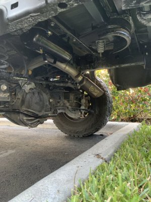

Modified Exhaust-High tuck Crawler
Carli 2.5 Pintop
Carli Torsion
Carli low and high stabilizer
Thuren Boogie bumps
Method NV 17x8.5
Toyo RT E 35x12.5
BAK MX4 Trifold cover
White Knuckle Sliders

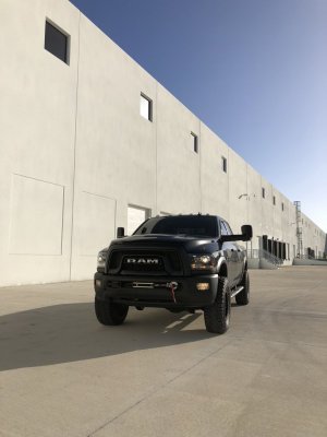

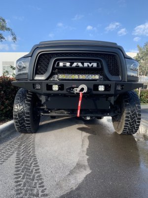

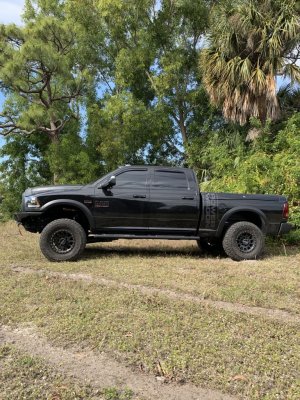

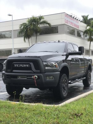

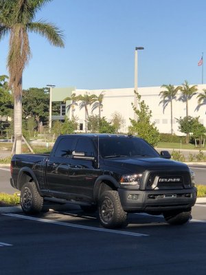

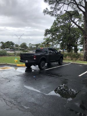

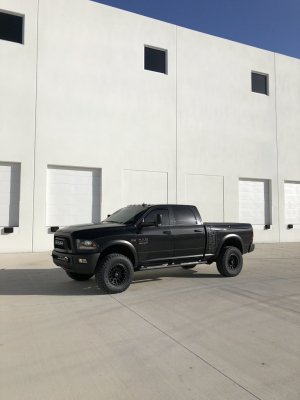

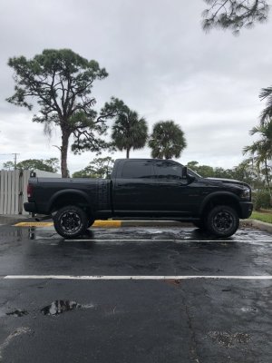

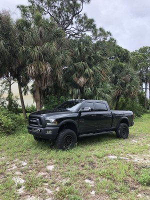

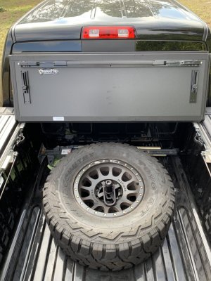

as it sits today

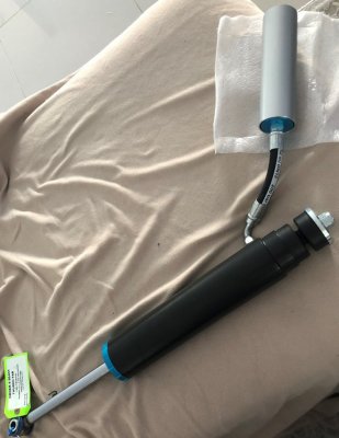

THUREN KING 3.0 FRONT
SHOCK POSITION
FRONT PAIR REMOTE RESERVOIR - FOR 2013+ 3500 / 2014+ 25 ...
SHOCK POSITION
FRONT PAIR REMOTE RESERVOIR - FOR 2013+ 3500 / 2014+ 2500
FRONT RESERVOIR MOUNTS
REQUIRED TO MOUNT THESE FRONT SHOCKS
VALVING TUNE OPTION
STAGE 3
Please enter truck information, suspension setup, use and other information that may help with shock valving. Example: 2006 Ram 2500, Thuren front coils, stock rear leafs with air bags. Tow 15k often on wash board roads.
DON LOADED CART. 2018 POWER WAGON. FOCUS ON WASHBOARD C ...
DON LOADED CART. 2018 POWER WAGON. FOCUS ON WASHBOARD CONTROL AND ALSO MODERATE REBOUND FOR SLOW SPEED STABILITY.
TF-KING30-RA-TF-KS30F-RA9-RESMK-13U$1,585.00
Ordered: 1
$1,585.00
THUREN KING 2.5 SHOCKS
SHOCK POSITION
REAR PIN-SHAFT PAIR FOR 2014+ 2500
NOT NEEDED. ORDERING REAR SHOCKS
LEAF SPRUNG 3500 REAR SHOCKS
I HAVE A 2500
STAINLESS STEEL SHAFTS
SHOCK BODY COLOR
BLACK CERAKOTE BODY AND BLACK RESERVOIR
ALUMINUM ENDS/CAPS COLOR
STANDARD KING BLUE
REMOTE RESERVOIR
STANDARD SILVER
VALVING TUNE OPTION
STAGE 3
YES I UNDERSTAND TIMELINE
WE ARE ON KING'S TIMELINE. 5-6 WEEKS MINIMUM.
NO TOWING. MODERATE REBOUND FOR EXTRA STABILITY
TF-KING25-RA-TF-KS25R-10PP-SS-SHAFTS-BLACK-BODY$1,345.00
Ordered: 1
$1,345.00
SUSPENSION ORDERED
Waiting game begins

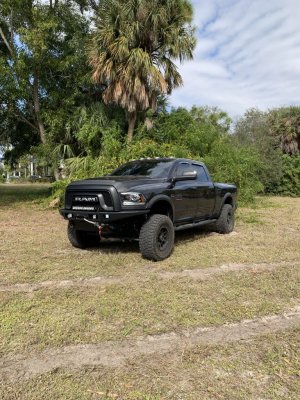

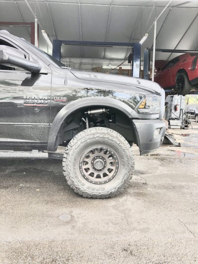

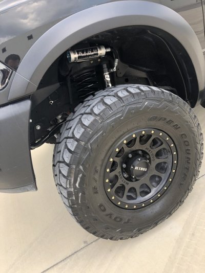

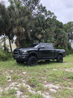

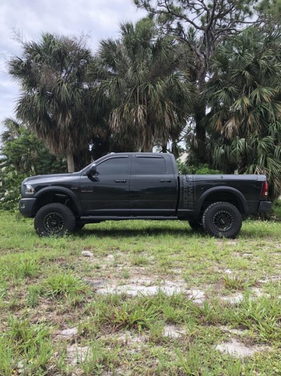

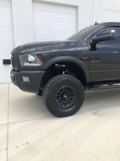

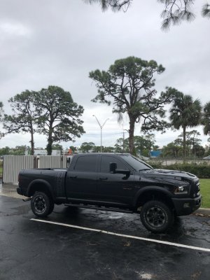

have my stock 2018 powerwagon finally riding on some real rubber.
35x12.5/17 Load E Toyo RT
17 Method NV
running 45PSI Front and 35PSI Rear
Stock Suspension
Rub on the rear lower plastic liner the juts out near the bottom outside corners of the front wheel wells. about 50% to full to lock it rubs.
only on slight off camber/uneven turns or with passenger. no wear yet, and i didnt want to chop anything because my lift is only a couple months away. no body modification if possible!
you could not offroad without constant rubbing. at least i wouldnt...

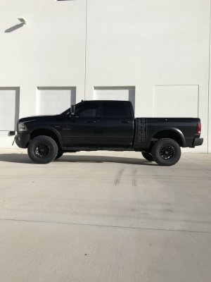

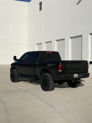

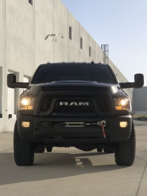

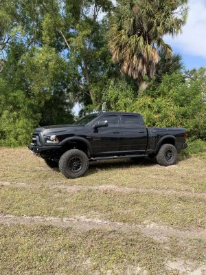

WOW what a feeling.
truly epic tuning and suspension setup. different truck all together. speedbumps get soaked up, highway entrance and exit banks have rollercoaster grip without feeling like your losing your contact patch. highspeed highway is smooth as a cadillac, and as always, the faster the smoother.
springs combo is incredibly ideal front and rear, super soft and spongy travel with the excellent compression and rebound feedback from the shocks All while providing that no jar trophy truck style ride.
offroad on rutted out fire roads with holes and loose gravel is insane. with the swaybar disengaged at 18MPH its fun, if i had a bypass switch for the lockers and swaybar, i would be in heaven. anything over 40MPH and your getting closer and closer to a cadillac..... so crazy, but maybe some dynamat and linex to muffle out the truck rattles, sounded like shaking a legobox
thats really all i need to say. recommend to anyone that feels the price is right and worth it.
any questions about the setup, let me know. otherwise, ill be out boogieing
what i really want is a supercharged 6.4 stage 6 all trussed up and a daily deleted and tuned diesel stage 2/1...
the shocks could be softer, my gf would be happier and i would be bored.
they could be stiffer and i would go full party and my GF would send me out the door.
Don can talk you through it, and i guarantee he can nail it. thumbs up all day

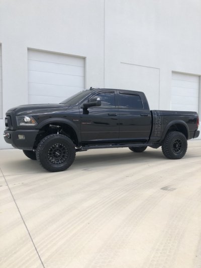

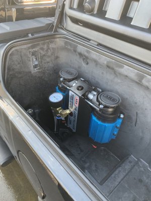

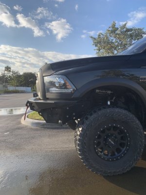

Thuren Bumper
Baja and Rigid lights
SPOD
Evo on demand swaybar disconnect
ARB twin compressor with 2.5 gallon tank
ABS kill switch
Locker Bypassssssss
