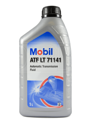

In my 2024 1500 classic, the ownership manual states to use this for the transfer case. It's as difficult to find as unicorn tears.
It's a golden color not red like ATF +4.
The price is.....
