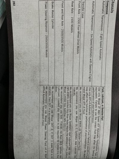

I will have to read my 2016 paper manual, but online it said 75-140 for the rear.
But, shhh, don't tell anyone, I have ran 75-90 Amsoil SG and it worked fine in the rear.
I do change the rear gear oil every year or 2 max since it is so easy and cheap to do - but I tow my boat over 3000 miles at 70+ mph also, so that is why.

The 75W-90 in the manual is interesting but I would use the 140 to err on the side of caution. Amsoil's website lists 140 for my truck as well as the 2018 year trucks. This is also what I run in my Dakota with 4.10 gears and an Eaton TrueTrac.

If I had a 2018 I would least ask why the spec changed, was there something different in the diff? If not, I'd have to agree, run the 140.

Yes, the reason redline hasn't updated their gear fluids spec list is because there hasn't been any change in gear fluids since gl-5, so the same thing you put in a ram back when gl-5 came out, you put in a ram today, YOU WILL NOT NEED THE MODIFIER EVEN WITH LSD. You can see here they say ram through 2006 if you look up oem capatibily. you can see on oil specs gl-5 was the last spec, so no reason to update, redline is gl-5. You DONT want to use this one (75W140NS GL-5 GEAR OIL) with either the open or lsd diff, you DO want to use this one (75W140 GL-5 GEAR OIL).
On the transmision, you would want to use d6 instead of c+ for the 8 speed, or any zf fluid, ravenol also makes a clone oil for the zf.
If your transfer case calls for atf4, you use redline c+, PM hemi395, he has the info on the BW transfer case, he uses an alternative that he digs, I don't know which one it is.
So you don't need the LSD fluid from Mopar with Red Line 75W140 GL5?

You wont need the modifier, there is 75W140NS GL-5 GEAR OIL or
75W140 GL-5 GEAR OIL, the one with the modern Ram spec is the second one, the one without the "NS". Redline stopped updating their specs because gl-5 has been here for a long time, so something recomended for a 2004 gear box is the same gl-5 as today.
When in doubt look at the specs.
