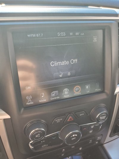

My ram is having the exact issue. I posted on the forum and nobody replied so I figured I was on my own.
I changed my battery and when I turned the truck on. My climate control is off nothing works at all and I lost my auto headlights.
I have the max care warranty so it went to the dealer yesterday.a302c7c4373a633edfc02c8128dee10b.jpg

Thats how mine looked - except I had done the radio upgrade.
I had tried everything. Pulling the battery, disconnected the HVAC, reconnected. In my case it was a bad harness, yours is factory, right?
