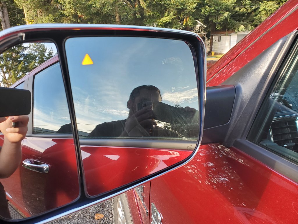

I just got my mirror glass and they are correct for tow mirrors.
Part # Left 68401395AA
Right 68401394AA
They moved where the wires hook up for the heated mirror, not a big deal to extend the wires.
All done! they fit just like the ones that came off, you have to transfer the anti shake clips from the old glass but they snap right on.

Is this glass auto dim?
