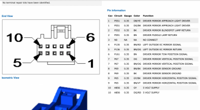

Im planning the re pin now, does anyone know what pin 4 and 5 are on c1? Shows "Outside RC Mirror Signal" Outside EC mirror return" I can't find anything that references that on the 2019 mirror.
Those are the connections for the dimming mirror glass.
Edit: Electrochromatic mirror signal and return.

Thanks. I can't to seem a match on my 2019 mirror. Maybe on the common driver?
Also, those of you who did just the glass swap. I don't see two wires for blind spot, just driver. I beleive the return should be grounded.
The return/ground for the blindspot shares the ground with the puddle light. Pin 2 on C1, it's the wire right next to where the blindspot power feed is which is pin 3

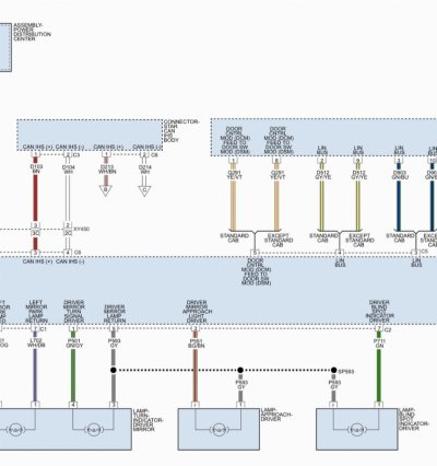

So I got the re pin done. Everything works as it should, including power fold, tilt on reverse and memory. I still need to wire up the blind spot from the tail lights, but this is all I could do tonight. Not to mention I still need some connectors.
I still don't understand the blind spot for the 2019 mirror. On door driver c3 for 2019, there is only one wire dedicated to blind spot, which i am assuming is the driver. I don't see a return wire for the 2019 mirror, that why i assumed t was to be grounded.

So I got the re pin done. Everything works as it should. I still need to wire up the blind spot from the tail lights, but this is all I could do tonight. Not to mention I still need some connectors.
