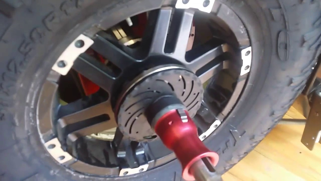

Interesting....I've never heard of this. My last 4 trucks all had aggressive, oversized, tires and all were road force balanced similar to the video below.
Quick_Shifter
IG: @ak_trucks_pa
TOTY Winner
Aug 14, 2018
4,343
4,347
ASTON,PA
AK Trucks Tuned 5.7
Yup. It works but it’s not fixing guys having vibration issues. It works great on street tires but it’s not dialing in a truck tire
