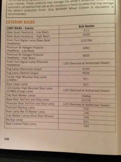

I have a 2019 ram 1500 tradesman. 24k miles. left rear blinker out. Cant find this bulb at any auto parts store. Ram dealer wants $39 for one stupid bulb. I asked for part number and he didnt want to give me it, I explained I paid 35 grand for this truck I'm not leaving without a part number. He gave me it. Its l0pwy24wsv It's not an led. It's about half the size of a regular looking blinker bulb. Google doesnt give me much info. Anyone know a decent priced replacement for this bulb?

Check your owners manual, there is a list of all the bulbs in it. According to mine, if you have the Non LED taillights, it should just be a 3157K bulb. I have a 2014 so don't know if it's changed since then but I don't think they they've changed.....bulbs.jpg
