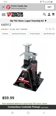

Not sure about a crank to lower the spare, reading here that its a ***** to get too. This Jack is awesome, light, easy to throw in the bed in a milk crate with other tools u need. dont have to worry about strapping an 80lb steel 3ton in the bed and destroying itScreenshot_20210313-173149_Chrome.jpg

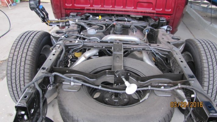

This is the hassle that you go through just to lower the spare tire
One thing i noticed, he lifts the tire to take the mechanism out of the rim, you don't have to lift it, you can do everything from the top
They talk about where the end of the tool goes under the truck, it looks like a funnel
If you look at the tools that are in the jack tool kit, the tool that fits into the funnel, is actually a Socket that fits onto a nut inside of the funnel.
One person made a tool that he says is better than the jack kit
He took a socket & welded it to a metal rod, then he took another cheap socket, either 3/8th or 1/2" & welded it on the other end, the end that was welded to the rod, was the part that usually fits a nut.
That left the square hole that you would insert a wrench into at the end.
He then could use a Speed wrench to turn the whole mechanism
I think that i would use a power drill with some kind of adaptor in it
A bit of advice, check your spare tire to insure that it is fully aired up.
Places like Tire Stores & dealerships, don't check the spare tires PSI, unless you ask them to check it
