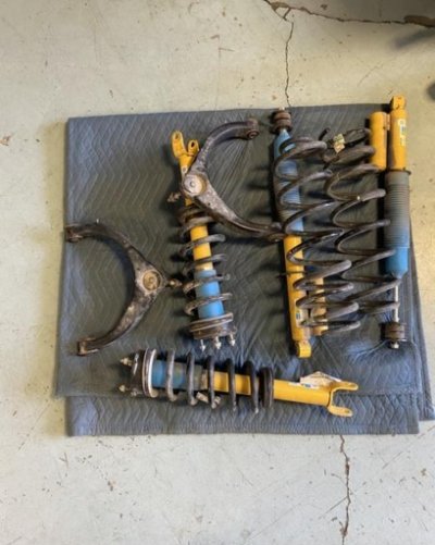

I came across a guy selling his stock suspension off his 2020 Rebel and it got me wondering if it would work on my 2015 1500. Does anyone know? I know it might be a long shot...

It's a possibility the coilovers and shocks may fit but I'm guessing the control arms won't. The vehicle weights are probably similar but the ride height might be different so the valving might not be optimal.
Is what he's asking for them going to be inexpensive enough to take the risk vs just buying new?

Front shocks would give you 2.5” lift though(4x4).
Bilstein 4600s all around, not going to win any Baja championships but solid OEM setup none-the-less.

I feel the control arms will work if you needed them for some reason . The regular 1500 arms have the little nipple on the side the same as Rebels last time I looked. That I think is attached to sensors same thing on rear stock control arms for rear IIRC

The struts might fit. I think there is a picture somewhere around with the factory strut, the 5th gen one and a 5100, and 5th gen compare to ours have the seat placed higher so you'll should get a lift with those assuming the upper and lower mount will fit. Give them a try hopefully they fit.
Can you measure from the eye of the lower mount to the top of the strut and post the value ? i'm curious how long they measure extended if you have them in your hands.
