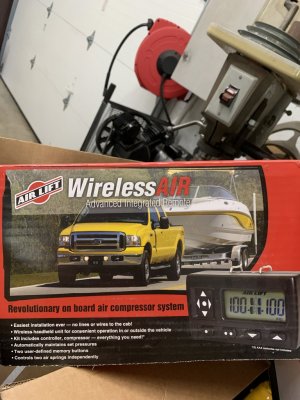

Gents, just picked up my 2021 and will need bags. I’ve been reading through the posts but would like info from someone who has installed on a 2020/ 2021. Can someone provide the specific part numbers for the cradles and bags? Any extra parts required? Not sure if I’m going to run onboard air or not yet. Best routing for the schreader?

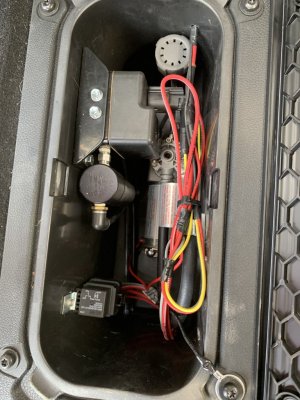

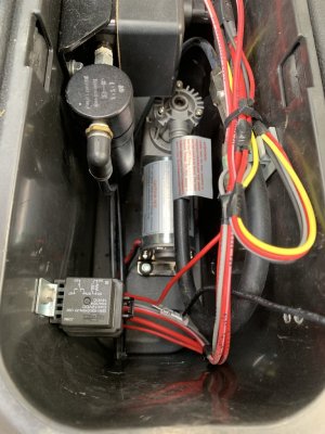

@Udy2554 I saw your set up in another post. If I do, that’s what I’m going to do. Clean install!
Crazyjerry, yes it’s for weight. We have a travel trailer and quad in the box. I’ll be over payload ratings so at least want the extra support.
