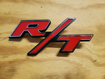

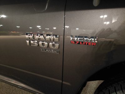

So the R/T badged trucks was only an appearance package. It had the hood with the fake vents, dual exhaust, body colored bumpers and the projector/led lights (plus the R/T badge). So I made my own. When I purchased my 2019 1500 regular cab short bed 2WD with the Hemi, it came with the body matched bumpers and single exhast. It doesn't have the hood or the projector lights, but personally I don't like fake vents. And I think the light output of the reflector lights is better. So I went on moparparts.com, and for $60 purchased an R/T badge for an earlier sport model and it clipped right into my grille in the factory position. The 1500's that come with a single exhaust are already made for the dual exhaust set up. I purchased a Borla stainless steel dual exhaust kit that bolted right in and utilized all the factory mounting points. Even the factory exhaust is bolted together now and I was able to swap out the single cat back system and install the new in about an hour and a half. Not to mention I didn't use the Borla muffler, I swapped that for a single in-dual out muffler delete pipe. The sound is amazing but cruising at 75 it's still quiet in the cab. You can also purchase the factory projector/led lights if you wish and switch them out. With Alfa OBD you then reprogram the ECM by "telling" it the truck has led lights and the projector housings and everything will work as if it came from the factory. Bottom line is you can get a Classic Ram and kinda make it the model you want with the OEM parts available out there. Not to mention the price, I got my Hemi for $26k brand new and for about $1,500 I made it the model I wanted.

6 Speed Cummins I love the regular cab, I know the R/T was just an appearance package but for years I anticipated I would buy a Sport regular cab. I live in NY so I was gonna get the 4x4 but with the Hemi and 3.92s its the same powertrain just with a transfer case added so why not add R/T badges, I was always curious about adding the stock 22" that came on the 2WD but I didn't know how I would correct the speedo and shift points. As I've been on this forum longer and longer I keep seeing stuff about this AlphaOBD and I'm interested. I bought a Craftsman code reader probably 8 years ago and still have it but it appears I'll be buying that set up because there's plenty to unlock with it. If nothing else I'll get it to program some more keys because I'm psychotic and like having 4 remotes to all of my vehicles. If anyone knows of anything else that I could unlock on a Warlock that would be worthwhile please let me know.
