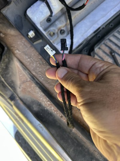

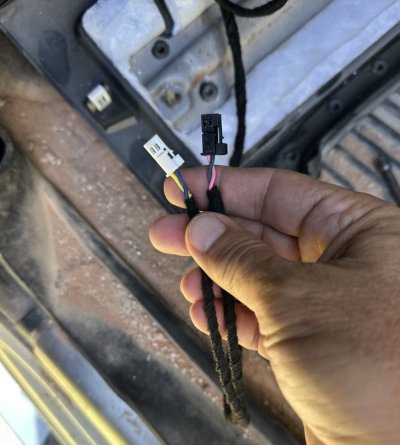

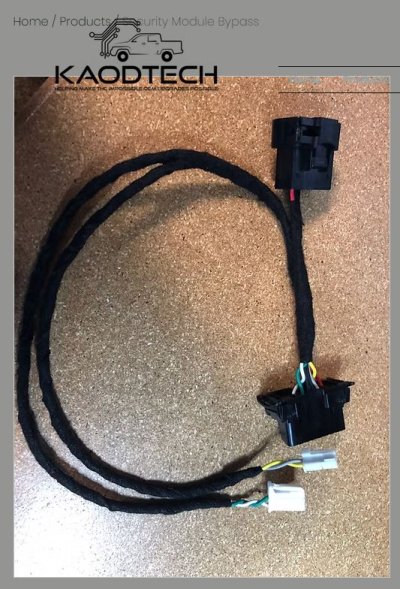

I think I got it. It seems their website pic is GRN/WHT and YEL/GRA. I pinned it out and the new one shipping seem to be GRN/PNK and YEL/BLU. Like you said I have a 50/50 chance on the first try and it seems GRN/WHT is now GRN/PNK and YEL/GRA is now YEL/BLU.
Everything is good. :waytogo:

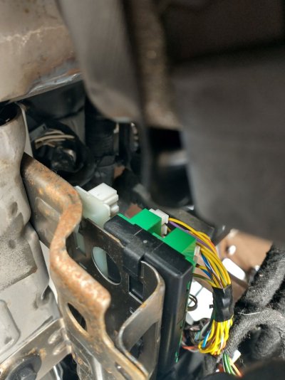

I haven't tried my OBDII yet, but I too have both green can blocks. I decided the by the pictures of the install on KAODTech website, the "green" block is the double row buss, and the "white" block is the single row buss.
