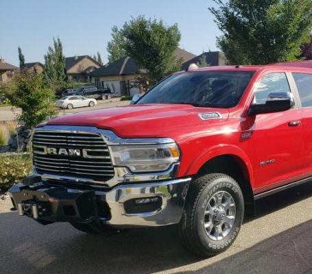

Warn Transformer winch mount solves the issue of replacing the bumper. This one is packing a 16,500 pound winch. These trucks weigh north of 8000 pounds with not much in them, small winches are not going to do much and reciever mounted winch with a snatch block pulling to the side will bend a lot of stuff.
