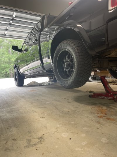

Might want to refer to my recent post at LINK
and most recently LINKY 2
And a few pics. Note the almost flat tires on the front in the second pic.
I'll be adding pic's of a cheap pump setup I used later :cheers:
View attachment 567352View attachment 567353
I got through my fluid change. Ended up with the rear tires around 12” off the ground….that had tranny rail level. Didnt like being under the truck like that though.
