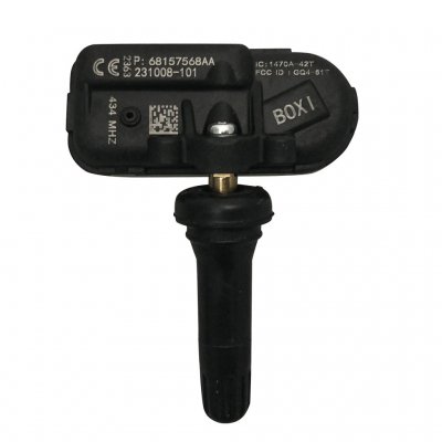

Something else to mention; even though you did say you like the OEM stuff and if you do end up getting a set of used Rebel wheels, you might want to find out beforehand what type of wheel sensors you have. I’m pretty sure the sensors in your wheels are probably the same as the later-year 4th-GENs and totally not like the wheel sensors that was in my old 08 where the valve stem was rigid and was part of the sensor that had a curve in it to match the profile of the wheel but, it doesn’t hurt to check. Who knows, you might even be able to reuse your same sensors with your new wheels.

You can reuse your factory sensors on another set of wheels. But it does require a rebuild for each sensor. Tires shops charge a minimal fee per sensor to do this. Or you can buy new sensors if you want to keep the sensors with the original wheels (like I did). And like corneileous said, as long as the tire diameter remains the same as stock, your speedo and odometer will be accurate. There are online tire size calculators for determining tire diameter based on tire size. I use this one...
Being that it’s that new of a truck, I don’t see why you would need a rebuild kit for the sensors unless perhaps since the valve stem seats inside the stem hole just like a regular valve stem, you may not be able to remove the valve stem without destroying it.
At least one thing about it though, if this is what the tire pressure sensors look like then you wouldn’t have to worry about replacing them for ones that are made for an 18 inch wheel like the sensors are, I’m pretty sure, in the old third gens.
Age isn't the issue. It normally damages or destroys the rubber valve stem when they remove them. The rebuild kit is a new rubber section.
They don't have different sensors for different size wheels, at least for 5th gens. He can use the sensors from his factory 22's in 18's with no issues. I have no idea about 3rd gen sensors so I can't speak for those.

Thanks all for the input. Just located a set of takeoffs with tires. Hope to pick them up this week and mount them this weekend.
The new set has the sensors so I should be good.

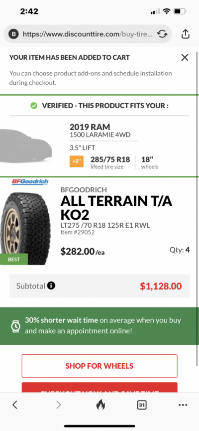

Just added these today as a Veteran deal. Came out to $1234.23 for all four.
