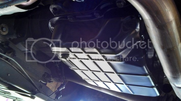

OK here are some pics. The best I could take. The plug setup that came in the pan is welded in and sits about 1/8" into the inside of the pan so it gives you a pretty good drain but won't come a hundred percent empty. It is a half inch deeper than the stock pan.

Looks good man! That drain plug is a nice set-up, will make fluid changes much easier!

Hmmm, nice pan.
May have to get me one eventually.
You got this off Rockauto, right?
