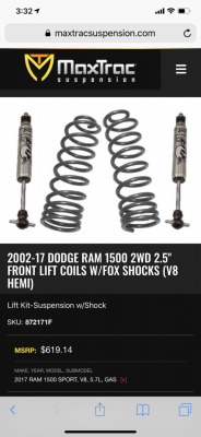

I wanted to go with 2.5 and maxtrac seems to only have 2 in for 2wd
Yes highly recommend the Maxtrac if you have 2WD as you can’t use the Bilsteins. I have a 2WD 1500 and I’m truly pleased with the Maxtrac 2.5 kit with Fox Shocks.

Maxtrac has 2.5" front coils for the 2wd RAM 1500, they will be Maxtrac 752425-8
CST also have 2.5" front springs, part# CSC-D3-3
Bilstein have 5100 front shocks, Bilstein 24-274999
But for a little more you can get Fox specific shocks for the 2wd RAM 1500, Fox 2.0's front, part# 985-24-096, this are a little longer than the Bilsteins and a much better shock overall.
For the back you can get Bisltein 5100 part# 24-275002, or go with the Fox 2.0's Part# 985-24-032
Depending if you need a little rear rake after that you can do Icon 1.5" springs and go with little longer shocks.
Maxtrac and CST also have lift spindles for 4-7" lifts and i think you can use same front shocks, and they have also longer springs for the back with longer shocks that will work with those springs.
Have fun

Yea looks like I’m going to go with could and shocks. Nick at gotexhaust quoted me a much better price than maxtrac’s site.
