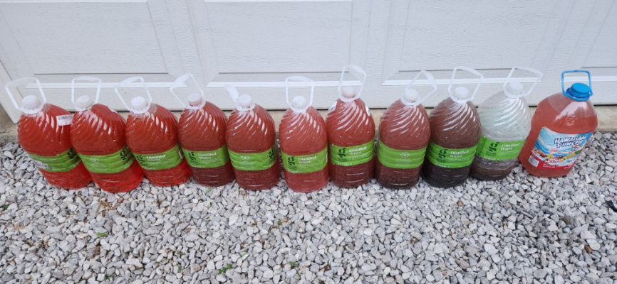

3.6 Pentastar
An observation with running mostly water in the cooling system presently. Temps generally stay the same while operating BUT with almost all water in the system temperatures can drop very quickly. Leaving the highway with coolant temperatures at 217 and Oil at 212 the coolant temperature dropped to 197 coasting to the stop light on the exit ramp. Ambient temperature was 81 degrees and overcast. It seems the system is striving at all times to get the coolant temps up to 220ish in my opinion.
I think I'll run another 10 gallons of distilled water through before adding coolant back into the mix...

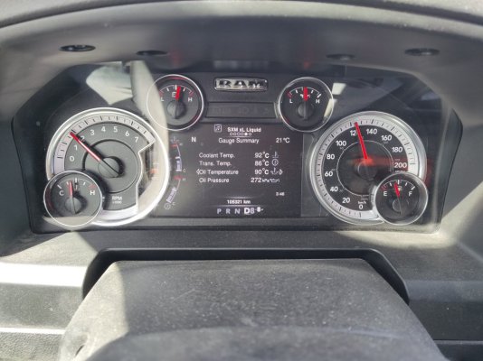

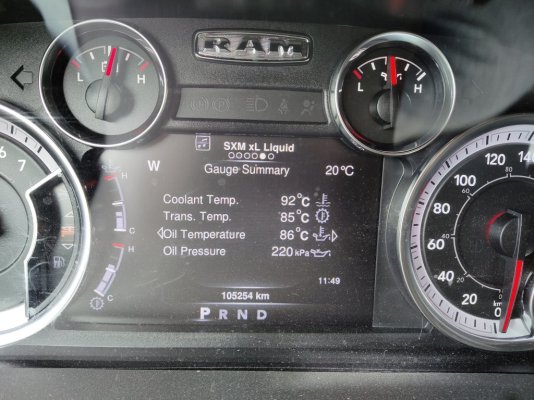

Does anyone else see coolant temps climb with the AC on at highway speeds? I’m assuming this is because the fan is programmed to come on at around 230 and never getting to that temp allows the system to park in the 220’s.
City driving temps with the Ac.
Highway with the AC. Note, Warlock models don't have grill shutters.
Thank you for that information. These are typical temps I see except in Fahrenheit. lol Only when the outside air temp climbed into the 33C range did my coolant temps rise with the AC on at highway speeds. Just not sure why that is as I was expecting the e-fan to bring them down. My truck runs much cooler without the AGS but since it was originally equipped with the shutter system the PCM probably has the cooling profile stored as such for the fan. What’s more concerning is my oil temp is always ten degrees higher than coolant temp after the thermostat opens.
