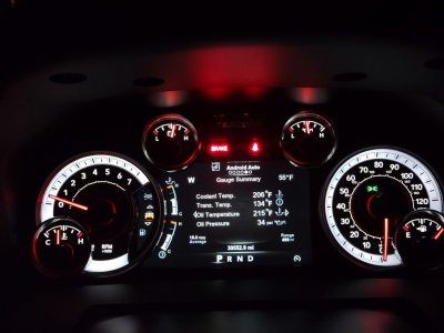

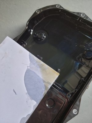

Wanted to post this just for info for anyone who is on the fence of changing their transmission fluid. I am just over 30k miles and decided to do my first transmission fluid change. For reference I did the transfer case and diffs at 10k so this is just standard practice for me. I also installed the Revmax bypass kit at the same time and it made a dramatic difference in transmission temps. I am a bit thrifty, so I bought a $35 ebay pan and a couple gallons of Redline D6. I also used one of the $10 home depot sprayer pumps to pump fluid. I would 1000% recommend this and not the crappy transfer pumps we have all used. A couple pics attached. The pan was almost identical down to the magnets. It came with all new bolts but one of the torx heads wasnt cut well so I reused an old bolt and trashed it. You can also see the fluid had already gotten fairly grey for only 30k miles on a lifetime fluid. The transmission shifts much smoother with the new fluid and the 2-1 shift coming to a stop is a lot smoother as well. I need to order some more fluid but plan do drain the pan again and refill in the next month or so.
Edit: Forgot to mention I took 5 quarts out of the transmission. Im guessing close to a quart was for the lines to the Revmax kit. It took right at 5 quarts to fill also.

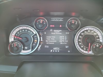

Before I was running the standard 180 to 190 degrees that everyone runs. I have only driven the truck a couple times since the change, but with 55 degree air temp the transmission would stay between 130 and 140 degrees on the highway. Coolant and oil seem to be running a bit hotter which makes sense that they arent losing heat to warm the transmission anymore. We were unseasonably warm this weekend for Colorado in March so I will update on temps when we get cold again and see how it does.

This morning on my drive to work the transmission temp only made it to 90 degrees. Granted I only drive about 9 miles to work and it was 40 degrees. I also feel like the new fluid has a bit less friction loss, the truck seems to be a bit peppier if that makes sense. Gas mileage was going up this morning too which doesnt normally happen on a colder morning. The smooth shifts were still there on a cold drive so I'm going to chalk that up to the fluid and not just running cooler. I need to find something to haul/tow so I can really test it out.
