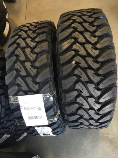

35s vs 37s Toyo AT vs Toyo MT
Snapped this at Tire Depot, Toyo MT 37x12.50 vs 37x13.50

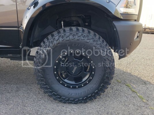

Ended up going with 37-13.5-17s on wheels with +18mm back spacing, did a little trimming and the don't rub. best of all, it still fits in the garage, barely!
