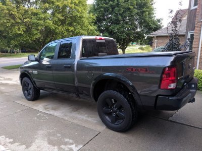

IMG_20190705_203636.jpg IMG_20190703_133749.jpg 2017 Outdoorsman, has a 2.5, 1.75 RC lift level. Running 275 65r20 at/3. Great tire for road and snow but the truck is no longer primary transportation so it's time to go bigger, more aggressive. I did have a 2014 with the same level kit and I ran 325 60r20 BFG K02. That truck however had the sport wheels which are wider. I am not sure if a 325 would sit on these wheels very well. Any how, question is, would a 33x12.5 look big enough or should I go 35x

Those tires are already 34s. Definitely jump to a 35"
There's alot of options in 35x12.5x20 which will fit. I have these wheels and they are 20x8, a bit narrow for a 12.5 wide tire but since it's not your daily drive abnormal wear won't be such a big concern.

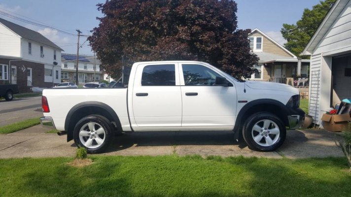

First pic is the 315s second is the stock 20s, even tho the stock 20s are 33s they look small. 4c279caf52735883d76549721b60349a.jpg2cfc07ff8a726bd63e8dc902f0dbc618.jpg

If those are 20x8 wheels then you’re technically not supposed to put 12.5 wide tires on them...just something to keep in mind...

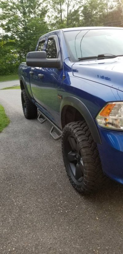

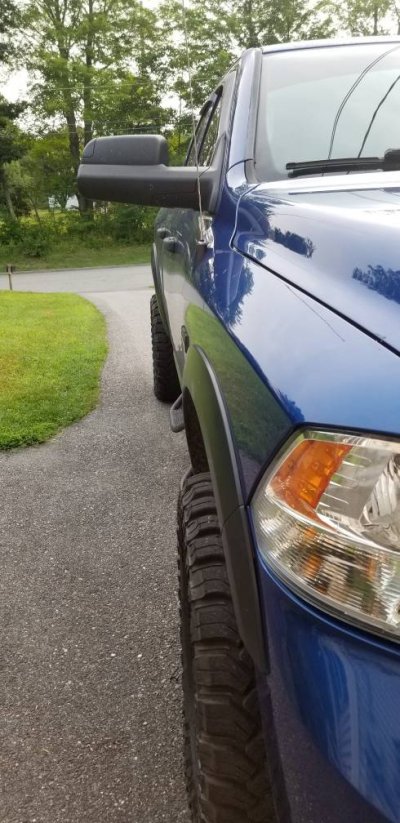

I went from a 275 65 20 general grabber at2 to 33x12.5r20 on stock rims, wanted the more aggressive look, I have 20x8,
2.5 front level, 1.5 rear spacer and 1.5 body lift
Tires I went with are wildpeak mt01'sdbce95fbd1bc272ac703cbc634a011c1.jpg8d76950599636e8d1e75e37e6b74e4ce.jpg539dbda2e4443b06f6e154861b5a05ac.jpg
