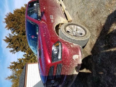

Ram Outdoorsman
Jan 28, 2016
112
88
I'm running a 35/12.5 on stock sport rims without spacers with bils set at 2.8. I only rub at full lock in reverse. Sorry she is a little dirty.

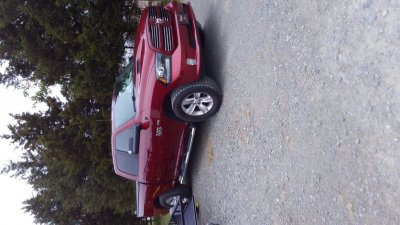

Ram Outdoorsman
Jan 28, 2016
112
88
Older pic but she is clean
