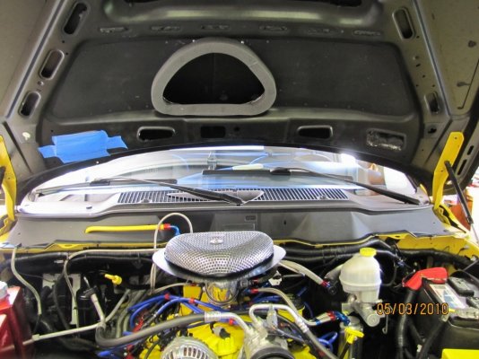

Only one i have seen on a 3G is otter1363
I can't believe that someone would go to all that trouble and expense on a motor, and not even realize the catch can is hooked up backwards and not even doing anything.
thats the air INLET for the PCV system, it's sucking air IN through that oil fill tube so it gets filtered air from the intake.
